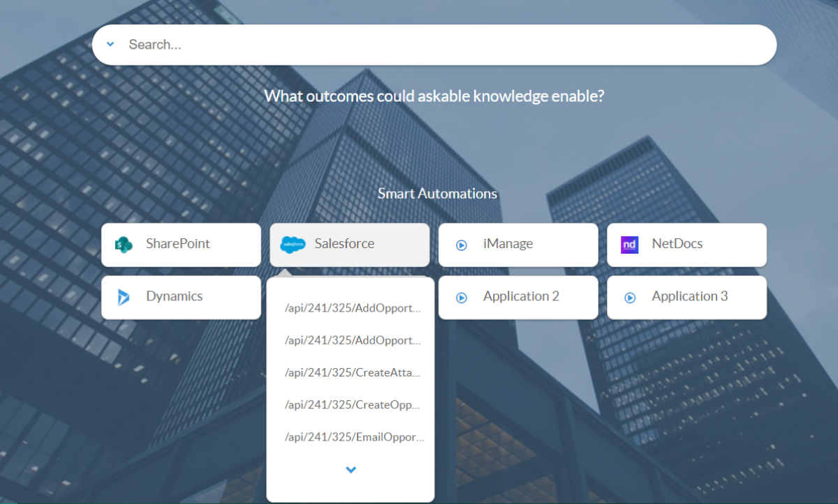

Interact with AppBus via Smart Automations

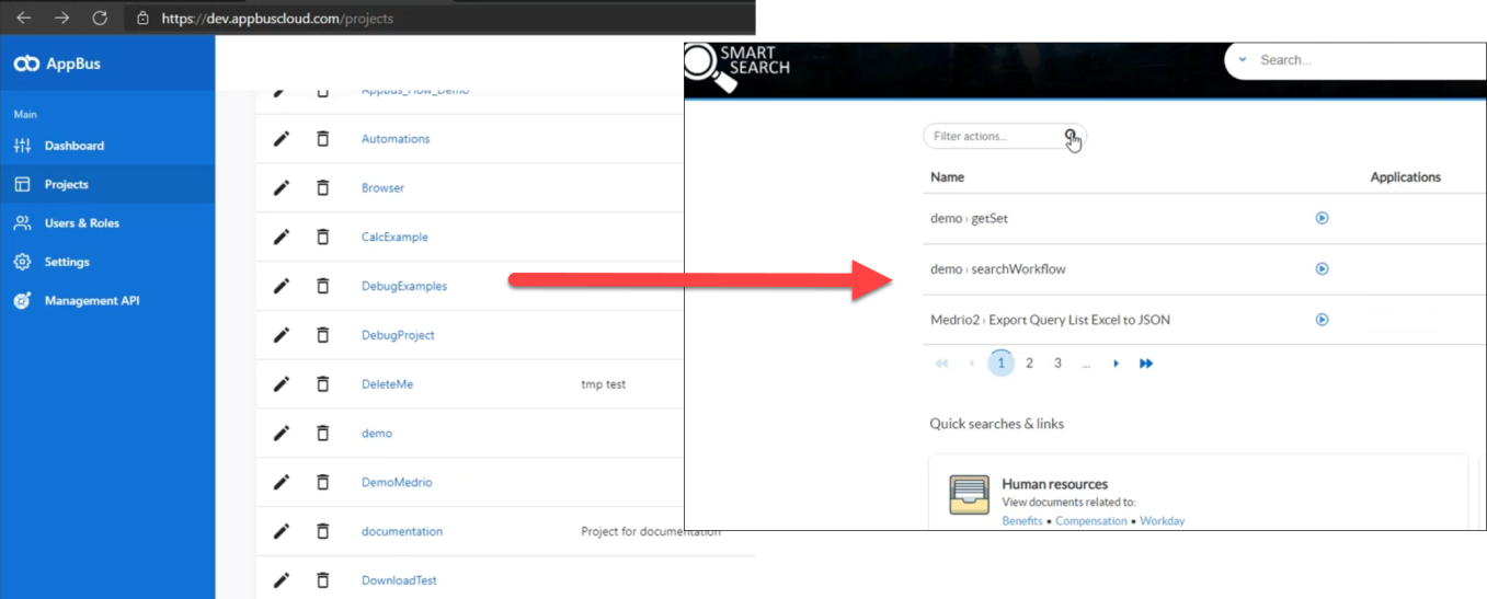

What Are Smart Automations?
Smart Automations is a component capable of displaying applications from your AppBus system into your SmartHub interface.
  • Within SmartHub, these executable applications can be called Smart Actions.
  • Users can interact with Smart Actions directly from the SmartHub search center.
  • In the image below SmartHub shows Smart Actions as:
    • <AppBus Project>: <action to trigger>
User Interaction
Users can interact with Smart Automations from your search center in 3 different ways:
  • By navigating to the out-of-the-box index or landing page of your SmartHub search center.
    • If you customized those pages then you must add code to the applicable page:
      • A DIV tag with the class "smartAutomations" must be inserted into the page: the component is displayed in that container
  • By navigating to the SmartAutomations SmartHub page located at: https://<web-app-url>/SmartAutomations.html
  • By using the "Smart Automations" button found in the Ribbon or Banner at the top of the page, when selecting your user picture

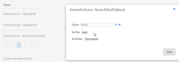

Smart Actions Search and Upload
In the example below, an action called "SearchAndUpload" is selected.
This action runs a query and uploads the documents returned to the NetDocuments directory "Documents" in the "legal" site.
  1. The "SearchAndUpload" action "run" button is selected.
  2. A window opens that enables you to select the parameters for the action.
  3. In this example the parameters include:
    1. Query - Term to query in Egnyte
    2. Sp Site - Site in which to store the uploaded file
    3. Sp Folder - Folder in which to store the uploaded file

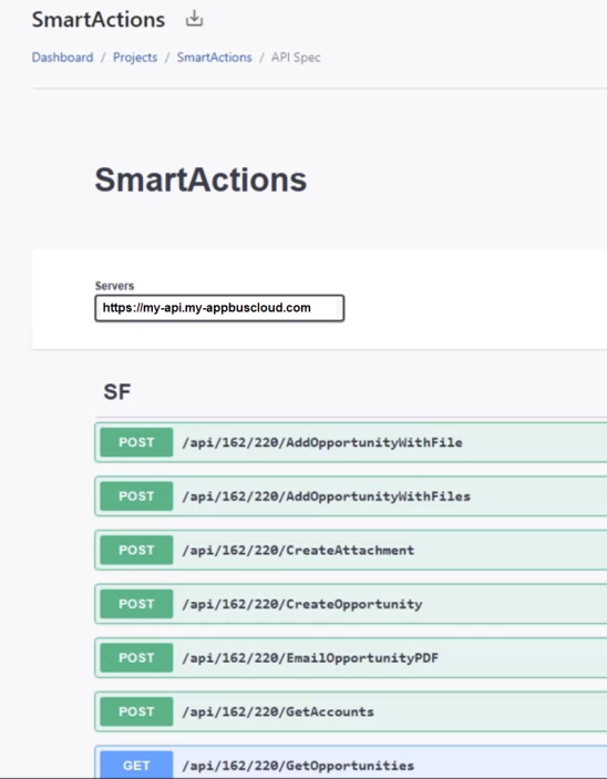

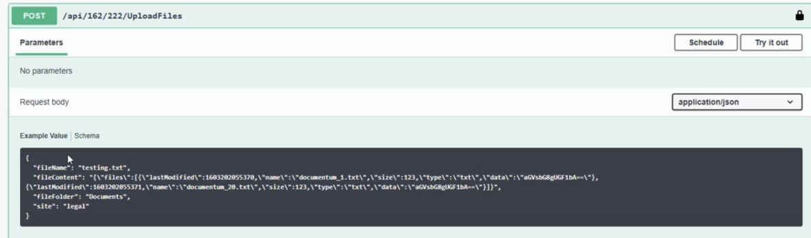

AppBus API for Smart Actions
A Smart Action similar to the one in the example above that uploads files to SharePoint is shown below in AppBus.
The API POST and Request body are shown for example purposes.

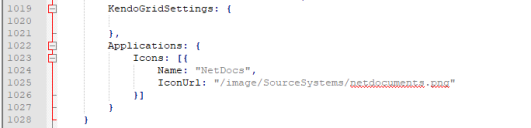

Applications
JSON
Default: unset
This is a JSON object that can be used to configure additional (tag, icon URL) pairs to be used in the component's Application column to showcase what applications a specific SmartAutomation uses behind the scene
Example:
(If an AppBus flow refers to the NetDocstag then the corresponding Icon URL is used)

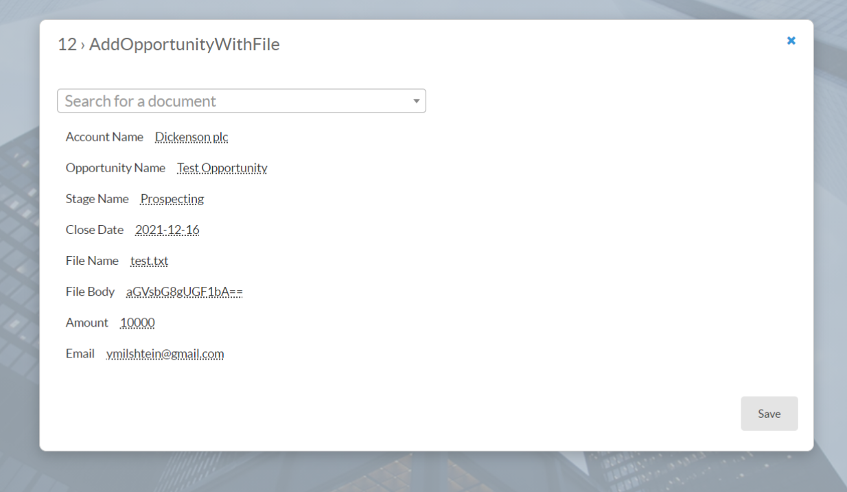

DocumentPickerSettings → EnableCondition
Text
Default: "actionMetadata.indexOf('FileName') !== -1"
This string represents a javascript code which is evaluated with the "eval" javascript command. This string must evaluate to a boolean value such as "true" or "false". If "true" then the action will have the document picker search box at the top. "actionMetadata" object is an array which contains all the Smart Action fields, as they are configured in AppBus

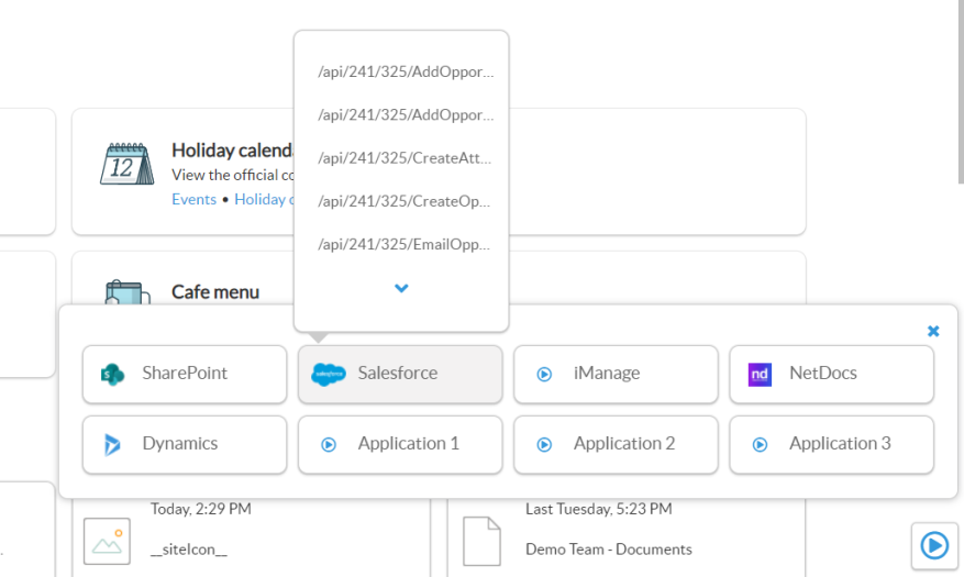

The Smart Automation module can also be displayed as a flyover by changing the ShowAsFlyoversetting to true.
  • BA Insight recommends you set Smart Automations as a flyover if you want to add the module on a search results page.
