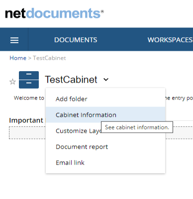

Verify Cabinet Administration Permissions
Verify the user account used the configure token authentication has cabinet administration permissions.
  1. In NetDocuments, open a cabinet that will be indexed by the BA Insight NetDocuments backend and searched by users.
  2. Select the drop-down menu for the cabinet and select Cabinet Information.
  3. The Cabinet administrator user accounts are shown listed here. See the image below.
    1. The user account used for token authentication MUST be shown in this list for each and every cabinet to be searched by the BA Insight NetDocuments backend.

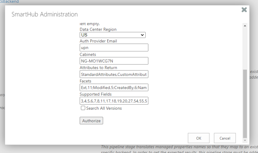

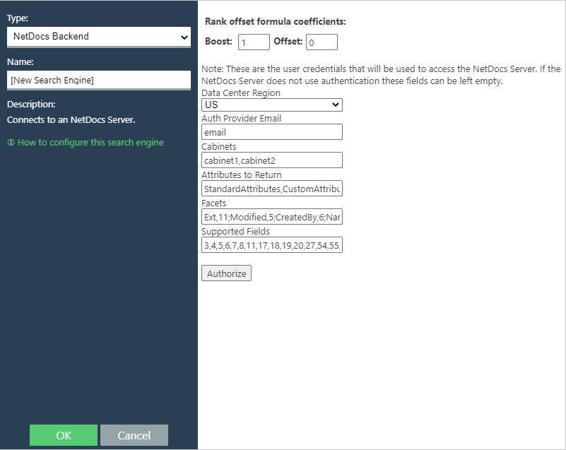

How to Add an NetDocuments Backend

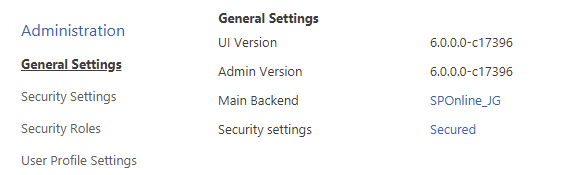

  1. Navigate to the SmartHub Administration page at http(s)://[web-app-url]/_admin
    For example: http://smarthub.azurewebsites.net/_admin .
  2. Go to the General Settings page.
  3. Click the "Add New Backend" link to add your new NetDocs backend.
  4. Next, enter the Backend Name and corresponding information in the appropriate fields.
    See the following graphic.
  5. Backend type: Select NetDocsBackend from the drop-down list.
Authorization
  1. Edit "Data Center Region" (Optional)
    1. If you are using the default Data Center (US) skip this step.
    2. If you are using a different Data Center, enter the appropriate value into the field.
      1. Supported Data Center regions are: US, UK, DE, AU.
      2. European users, use UK.
  2. Use your NetDocs account credentials to log in. IMPORTANT: Your user account MUST have Administrator permissions to all the NetDocuments cabinets to be searched.
  3. Click the "allow" button to give the application full access to all resources.
    Note: If you have multiple repositories, and you want results from all of them you must set up a different NetDocs backend for each repository
  4. Click Authorize
  5. From the Configuration page, copy the code in the Authorization Code text box.
  6. Click Get Access/Refresh Tokens
  7. Copy and paste the Access and Refresh tokens.
  8. Click the OK button.
    1. Rank offset formula coefficients (optional): Enter these values only if you selected the Rank Based mixing algorithm that is set in the Properties for SSA page:
    2. BOOST: Enter the boost factor.
    3. OFFSET: Enter the rank offset.
Use the following table to specify this code:

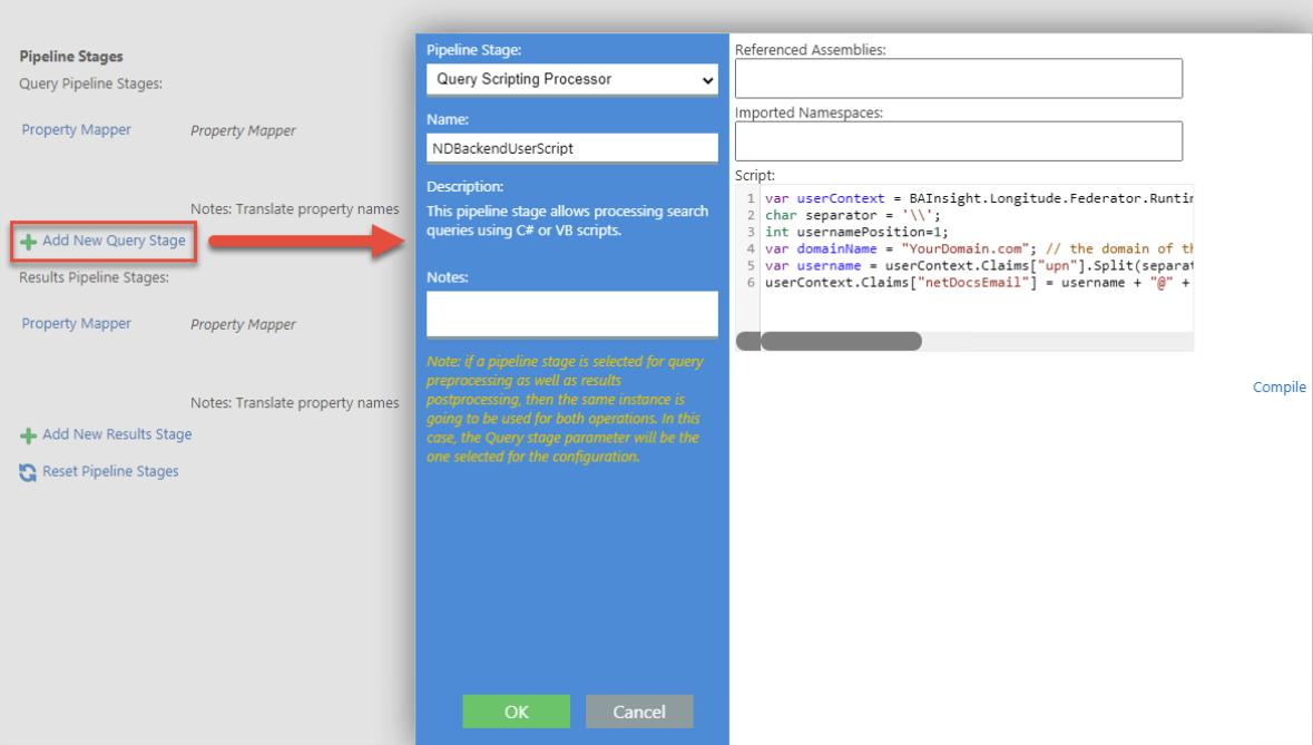

How to Configure Security Trimming for Windows Authentication
After you have configured your NetDocuments backend, as described above, use the instructions below to insert a script to enable SmartHub to trim query results according to each user's access rights.
  1. Under Pipeline Stages for your NetDocs backend, select "Add New Query Stage".
  2. Select Query Scripting Processor.
  3. Name the pipeline stage.
  4. Referenced Assemblies and Imported Namespaces: Leave empty for this script.
  5. Enter the code in the code block below into the "Script" field.
    Enter the appropriate values for the following settings:
    1. var domainName:
      1. Enter your domain inside quotes "".
      2. For example, "acmedomain.com".

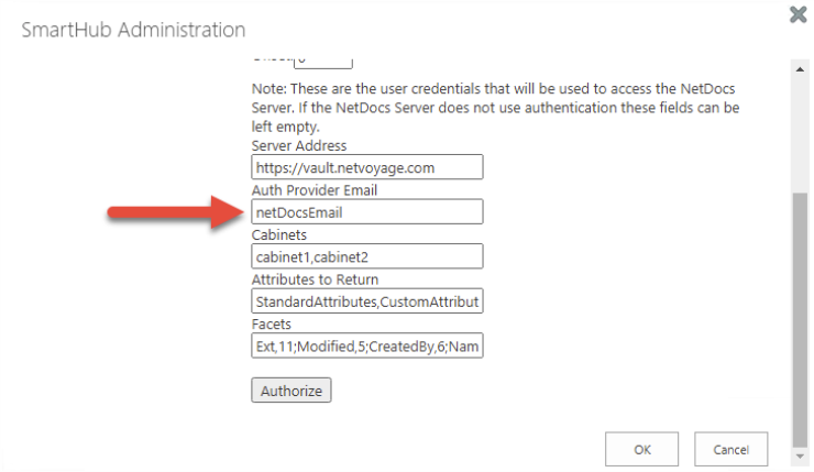

    2. userContext.Claims[]:
      1. This value ("netDocsEmail" in the code below) can be any text.
      2. Add this value to the NetDocs Backend settings by replacing the current value in the Auth Provider Email property field (see below "NetDocs Backend Settings").
        Copy
        var userContext = BAInsight.Longitude.Federator.Runtime.Security.SecurityUtil.Load() as BAInsight.Longitude.Federator.Common.Util.OAuthUserContext;
        char separator = '\\';
        int usernamePosition=1;
        var domainName = "YourDomain.com"; // the domain of the user account
        var username = userContext.Claims["upn"].Split(separator)[usernamePosition]; // this retrieves the user name
        userContext.Claims["netDocsEmail"] = username + "@" + domainName;  // this generates the user address in the required format: username@domain.com
        • NetDocs Backend Settings
  6. Click OK to close the window.

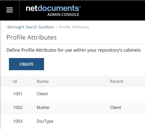

How to Configure the NetDocuments Properties to Return
Perform the following steps to discover properties in NetDocuments that you can map in SmartHub:
  1. Log to NetDocuments with an Admin account.
  2. Access the Admin Console by clicking "Admin" from the top right drop-down menu.
  3. Go to the Navigation menu (top left) and select "Profile Attributes".
  4. The Profile Attributes or similar window appears, as shown below:
  5. Use the property names and numbers ("Id" column) shown here in the SmartHub Property Mapper.
    1. Examples: MatterId,1002;
    2. For nested profile attributes, you can reference them by their ID preceded by their parent ID.
      1. Examples: MatterId, 1001.1002;

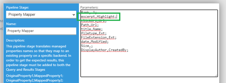

  6. You can add custom results properties in your custom settings file, under FieldstoInclude of the ContentContainers section:
    Copy
    Custom Settings Example
    SH.ContentContainers = SH.ContentContainers || {};
    SH.ContentContainers.CustomSettings = {
        MainResults: {
            FieldsToInclude: 'clickUri,title,Rank,ContentSource,FileExtension,excerpt,SDFUrl,date,DisplayAuthor,isUserProfile,isAuth,isError,HitHighlightedSummary,WorkEmail,JobTitle,Department,AboutMe,escbasecrawurl,UserName,PictureUrl'

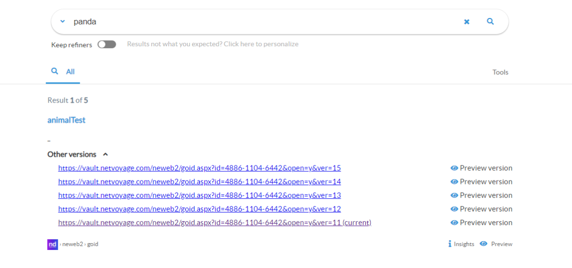

    2. For nested properties, like Versions,CheckedOut or Email, you can access them via Versions.Official or CheckedOut.Name
      1. Versions accepted fields:
        • Annotations, AutoVersion, Count, LatestVersionLabel, LatestVersionNumber, Official, OfficialVersionLabel, OfficialVersionName, SearchInfo, TotalSize

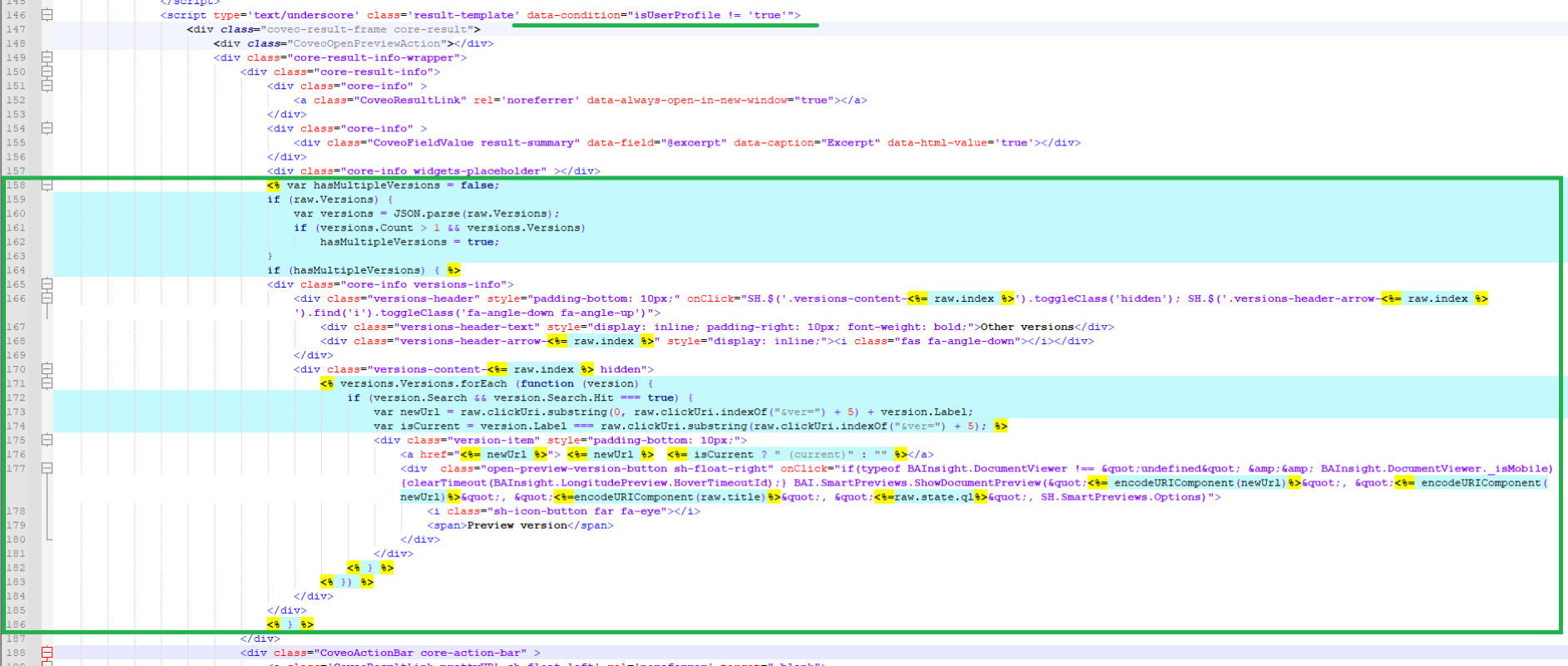

  • Put the following code snippet in Results.html (or your custom Results HTML file) if you want to use a date refiner:
Date Refiner Code Snippet:
Copy
<div class="CoveoFacet" data-default-state="collapsed" data-title="Modified Date" data-field="@date" data-lookup-field="@date" data-available-sorts="occurrences,alphaascending,alphadescending"></div>
