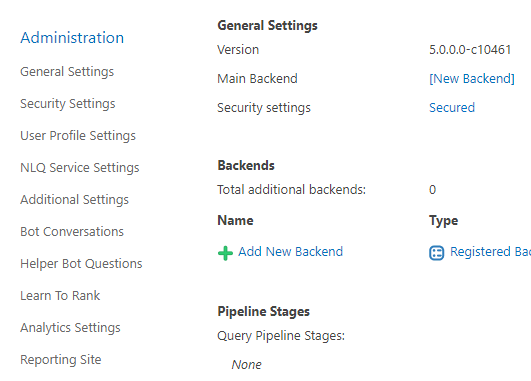

- Navigate to the SmartHub Administration page at:
http(s)://[web-app-url]/_admin
- Click Main Backend > Edit backend settings to see the Backend Settings pop-up window:
