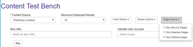

  • For example, the TikaExtractor Stage uses this tag: [AppliedProcessing(ProcessingTypeFlags.BlobProcessing)]
  • If from the Test Bench you select Skip FileData stages, the Tika stage will be skipped.
