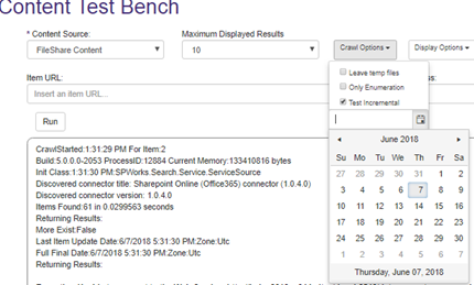

      • Test Incremental
        • Click and use the calendar to select a date.
        • Only the items that were modified on, and after this date are crawled.
Caution: The test bench does not store any information for previous crawls or previous tests.
If you choose to perform an incremental testing operation, you cannot choose to use the Item URL functionality.

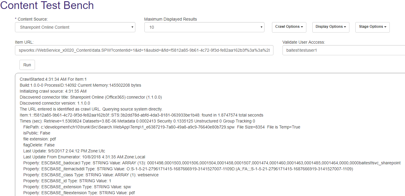

  • Item URL
    • Enter the URL of the item in order to search for a specific document.
    • The URL text box supports crawl URLs:
      • Crawl URLs:
        • These are the internal URLs that are used during indexing.
        • These URLs have the prefix "spworks://" and can be found in the crawl logs or test bench.
        • For more information, see Configure Log Files.
The following URLs are not supported:
  • start.spw
  • paging.spw
The Item URL functionality is compatible with all the test bench settings except the Test Incremental operation that is explained above.
If you choose to specify a URL in Item URL and you also select Test Incremental, the incremental test operation does not run.

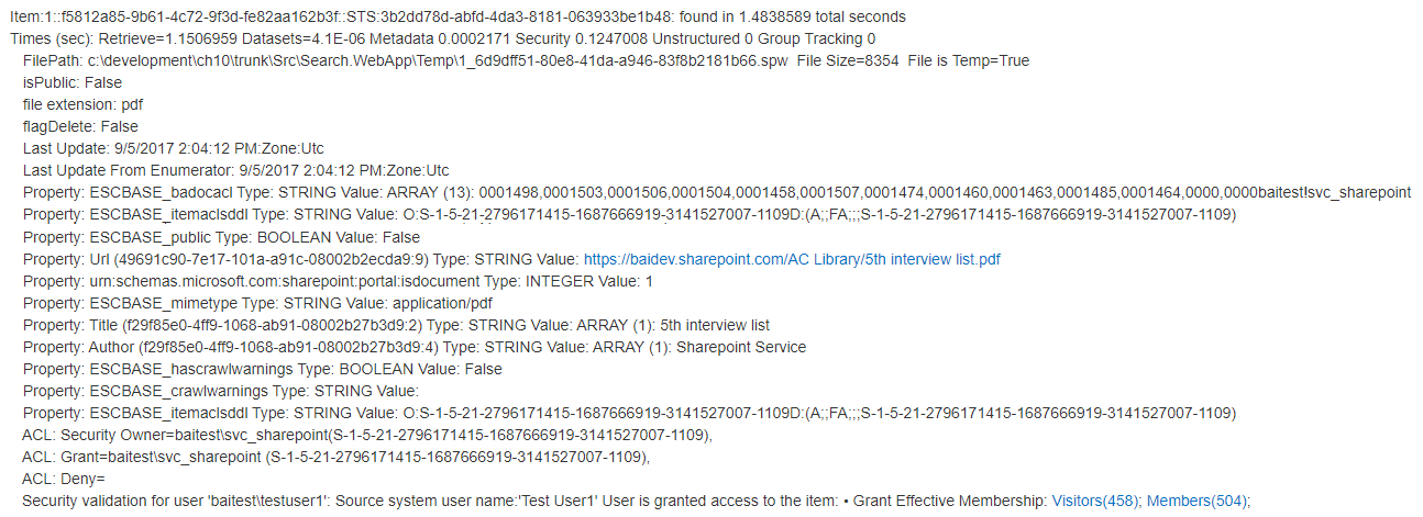

  • Validate User Access
    • Enter a username
      • Use the format: Domain\user. (If you try to specify "user" instead of "Domain\user," an error is thrown.)
      • See the following example of the results of this operation:
      • In this example:
        • The item is accessible for the Visitors and Members groups.
        • The user accountbaitest\testuser1 is a member of groups Visitors and Members.
        • ...because of this, testuser1 is granted access to the item.
Caution:
If the test bench detects that multi-level security is returned, the test bench does not evaluate the specified user's security.
The following error message is returned: Security validation for items with multi-level security is not supported.
The GRANT and DENY ACLs are displayed.
The test bench also confirms that security is correctly applied for the specified document.
The user sees items that are both granted and denied for each specific user (User is denied access to the item: Item does not contain security information for the specified user or User is granted access to the item: Grant Effective Membership: User specific access granted).
Suggestive messages appear for users that do not exist or are not mapped to the AD.

When you choose to retrieve a specific file, you use the URL that is found in the crawl log and paste this URL into the test bench.
  1. Navigate to your search index and retrieve the escbase_crawlurl metadata for the record you want to inspect.
  2. Copy the metadata value.
    For example:
       spworks://WebService_x0020_Content/data.SPW?contentid=1&id=1&subid=&fid=f5812a85-9b61-4c72-9f3d-fe82aa162b3f%3a%3a%2bS%2bT%2bS&fsubid=3b2dd78d-abfd-4da3-8181-063933be1b48%3a&encoded=True&site=&csid=0&stype=test
  3. Go to Content sources >> Test, add this metadata value in the Item URL text box, and run the Test Bench.
  4. View the results.
