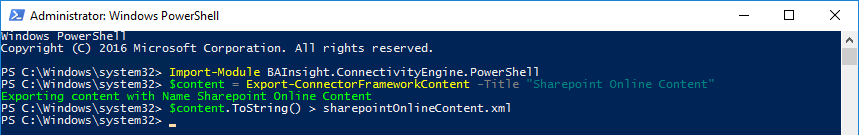

How to Export Your Content and Connection Using the Export cmdlet
Using the export cmdlet command, you can export your content and connection to an XML object and save it to disk.
Use the following steps to use export cmdlet to export your content and connection.
  1. Select the content you want to export:
    $content = Export-ConnectorFrameworkContent -Title "Sharepoint Online Content"$content.ToString() >> sharepointOnlineContent.xml

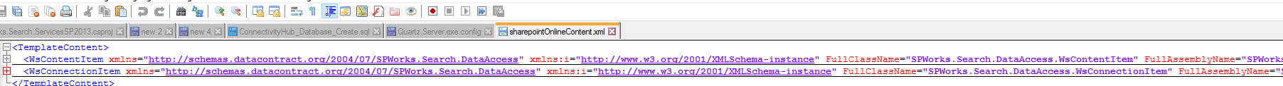

  2. Check the XML file just generated.
    The file contains a serialized representation of your content and the associated connection.
    See the following graphic.
  3. Use a text editor to modify the various available properties.

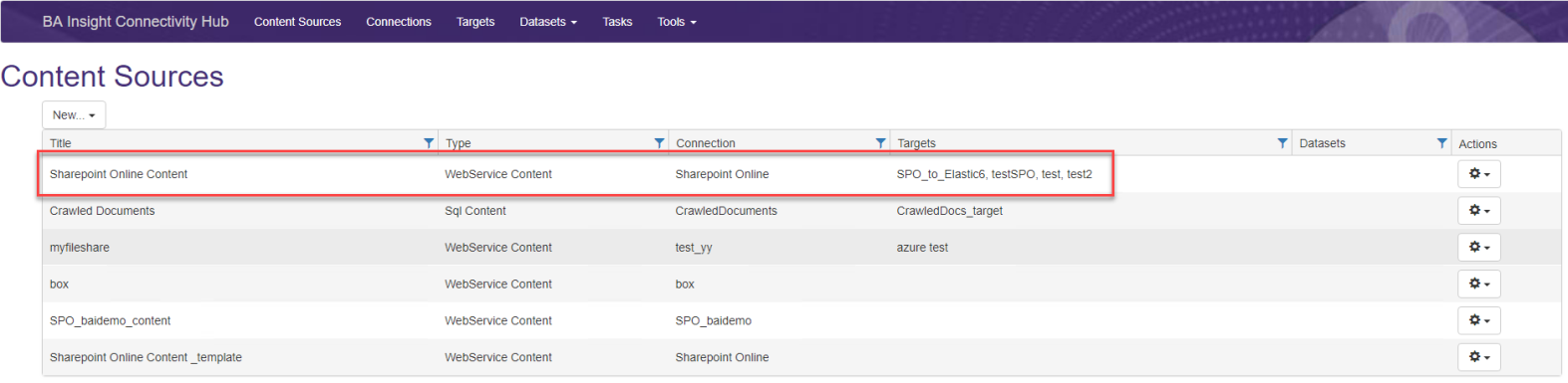

  2. Back in Connectivity Hub, the content appears in your list of contents:
  1. The metadata associated with your content is exported/imported.
  2. Use the Metadata page to generate metadata.
