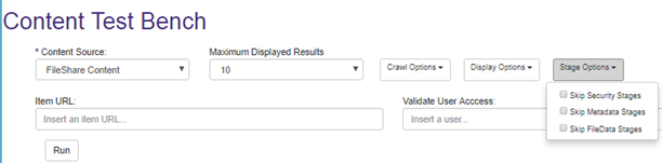

How to Change Metadata, Security, and Unstructured Data
You can implement stages to change metadata, security, and/or unstructured data.
Depending on the stage description, specify at least one attribute that will define what area your stage affects.
For example, the TikaExtractor stage uses this tag:
[AppliedProcessing(ProcessingTypeFlags.BlobProcessing)] -
If you select Skip FileData stages from the Test Bench, the Tika stage is be skipped.
You can define the ScriptingStage.template to change any of these (metadata, security, or blob).
For this reason, this class applies all tags:
