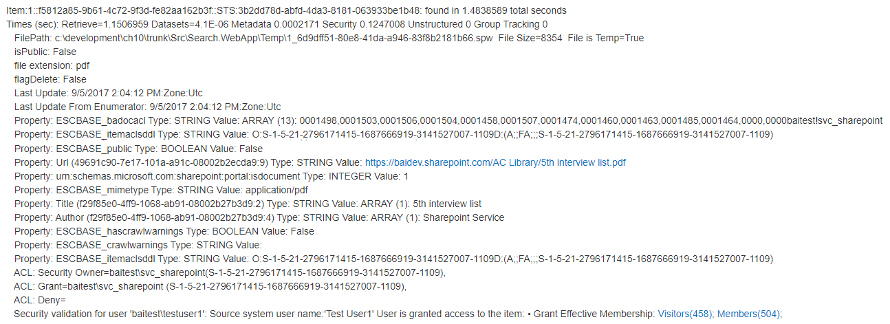

      • See the following example of the results of this operation:
      • In this example:
        • The item is accessible for the Visitors and Members groups.
        • The user account baitest\testuser1 is a member of groups Visitors and Members.
        • ...because of this, testuser1 is granted access to the item.
Note: If the test bench detects that multi-level security is returned, the test bench does not evaluate the specified user's security.
  • The following error message is returned: "Security validation for items with multi-level security is not supported."
    The GRANT and DENY ACLs are displayed. The test bench also confirms that security is correctly applied for the specified document.
  • The user sees items that are both granted and denied for each specific user (User is denied access to the item: Item does not contain security information for the specified user or User is granted access to the item: Grant Effective Membership: User specific access granted).
  • Suggestive messages appear for users that do not exist or are not mapped to the AD.
  • In Test Bench, the escbase_itemaclhr property, which displays the permissions of a particular item, will only show level 0 permissions.

How to Validate the Security of a Specific User
This operation works for both AD and native security.
  1. Navigate to Content Sources.
  2. Click <your content source type> > > Test to see the Content Test Bench page.
  3. Validate User Access: Enter the name of your user.
  4. Run: Click to see if the user account is found in the Active Directory.
This operation works for both AD and native security. For more information, go to Security Model.
