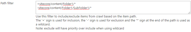

There is an optional content setting to filter items during crawl.
- Specify a list of paths to be included or excluded during a crawl.
 - The paths must be separated by new lines.
 - Wildcards (*) and both inclusion and exclusion rules are supported by preceding the path with the +/- signs.
 - Exclusion rules have priority over inclusion when using wildcards.
In the example in the picture below, everything "under" Folder1 is crawled except SubFolder1.
