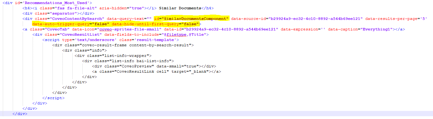

To add a Close button to your Content-by-Search component, add your code in the following format to your Content-By-Search <div> element:
<div data-action-type="hide" data-hide-target="#SimilarDocumentComponent" class = "sh-float-right sh-modal-btn-close"></div>
An example of the code within your Content-By-Search component, appears below (highlighted)L
The value of the data-hide-target attribute is the ID of your Content-by-Search.

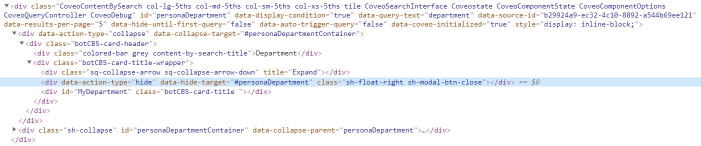

How to Add an Expand Button to Your Content-by-Search Component
To add a Collapse button to your Content-by-Search component, add your code in the following format to your Content-By-Search <div> element:
<div data-action-type="collapse" data-collapse-target="#botCbsContainer">
<div class="sh-collapse" id="botCbsContainer" data-collapse-parent="#botCbs">
  • The value of the data-collapse-target attribute is the ID of the content from your Content-by-Search.
  • The value of the data-collapse-parenta attribute is the ID of your Content-by-Search.
In order to inject an expand button, add a wrapper class title and icon.
<div class="cbs-title-wrapper"
    <div class="sh-icon-button sh-float-right" title="Expand">
        <i class="fas fa-angle-down"></i>
        </div>
</div>
Example
An example of the code within your Content-By-Search component, appears below:
