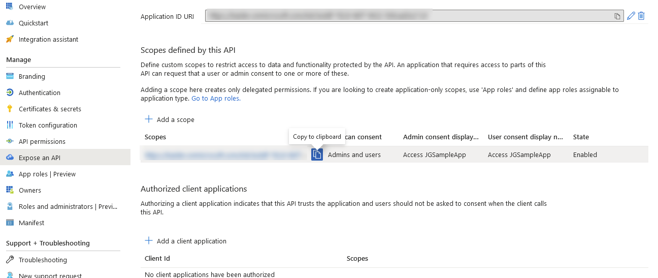

  4. Create the App ID URI.
      1. Click Expose an API section on the left side navigation menu.
        1. To manually set your App ID URI, click Set at the top of the page.
        2. To set your App ID URI automatically, continue to add a scope, below.
      2. Click the Add a Scope button.
      3. In the window that appears, note the Application ID URI is shown below the "Scope name" field (with the field empty).
        Configure a scope to be used by SmartHub to provide permissions-based access to its resources.
        1. Scope name: Enter a scope name
        2. Who can consent: See here for more information.
          1. Admins and users - Every user can themselves consent; they will see the message to “SmartHub wants to sign in as you”.
          2. Admins only - Admin consent serves as pre-consent for all users.
        3. Admin consent display name: Enter a consent display name.
        4. Admin consent description: Enter a description for the Admin consent.
        5. User consent display name: Enter a name for the user consent.
        6. User consent description: Enter a description for users consenting to the API.
        7. State: Enable or Disable the scope. This can be changed as needed.
      4. When done, click Add scope.

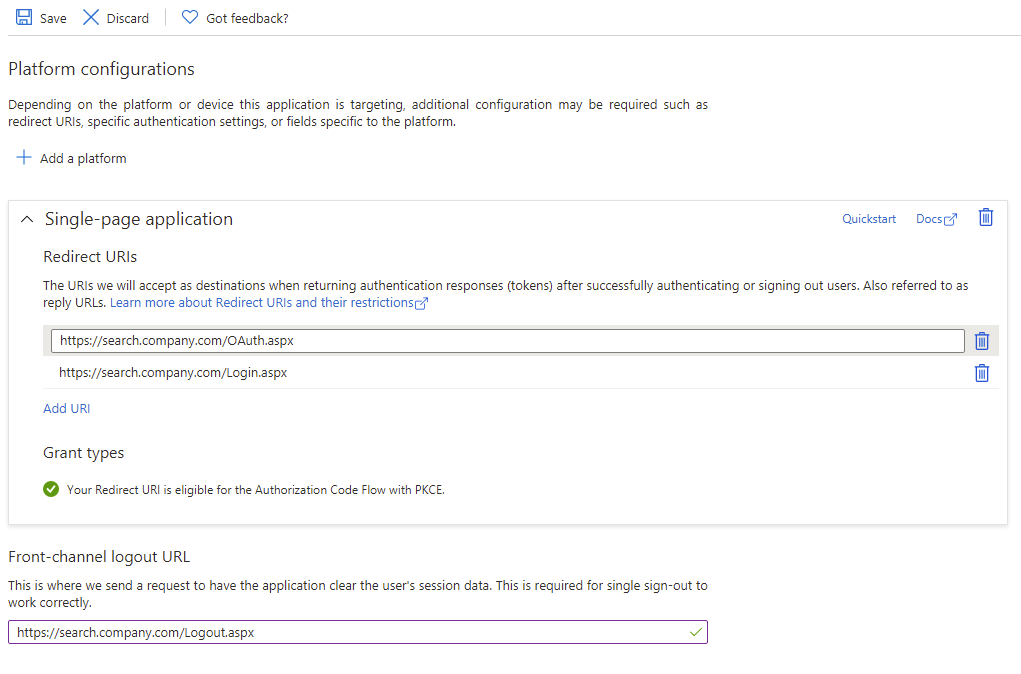

Redirect URIs
Enter app Redirect URIs (previously called Reply URLs).
  1. Click Authentication from the left-side navigation.
  2. Click Add URI under Single-page application in the middle of the screen.
  3. Enter <your app Redirect URIs> in the format: https://search.company.com/(OAuth/Login).aspx
    1. These addresses must start with https
    2. These addresses are case-sensitive.
    3. You must enter both Login and OAuth URIs.
  4. Logout URL: Enter the log-out URL in the format: http://search.company.com/Logout.aspx
Note: If you have existing Redirect URIs, recreate them anew instead of migrating them to the single-page application (SPA) platform configuration.
  1. Click Save at the top of the page.

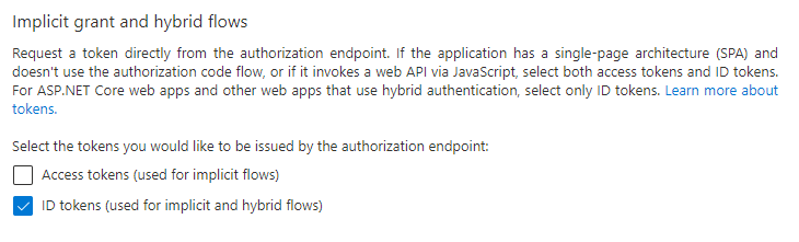

Implicit Grant
If you use a SharePoint Online search engine enable Implicit Grant for ID tokens:
  2. Scroll down to Implicit grant and hybrid flows.
  3. Ensure that the ID tokens option is enabled.

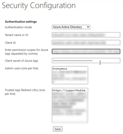

Enter Your Authentication Settings (Azure AD) in SmartHub
  1. Navigate back to the SmartHub Administration page by going to the _ADMIN folder and navigating to the SmartHub admin User interface (UI).
    Alternatively, enter:
       http(s)://[web-app-url]/_admin
  2. Select Security Settings.
  3. Authentication mode: Select Azure Active Directory.
    1. Tenant name or ID (required): Specify your Azure tenancy name in this format:
      1. contoso.onmicrosoft.com
        or
      2. Enter your tenant ID
    2. Client ID (required): The "Application ID" as shown in the Azure Portal App Registration page for your application.
    3. Enter permission scopes for Azure App separated by comma: Paste in the custom scope defined in your Azure App from the "Expose an API" section. See the screenshot below.
    4. Client secret of Azure App: Enter a client secret if you have configured a Sharepoint Online search engine.
    5. Admins users (one per line): The local administrator account(s) in the format domain\user. Enter one user account per line.
    6. Trusted App Redirect URLs: List of application URLs that use SmartHub to validate the user's credentials.
      1. This also includes custom DNS names used for the server hosting SmartHub.
      2. All BA Insight applications integrated with SmartHub are listed here.
      3. For example, see the following application URLs (some optional):
        1. SmartHub site URL: The SmartHub site address, as accessed by users.
          Note: You must list any registered DNS names that access your SmartHub server. Otherwise, users will not be able to authenticate with SmartHub.
        2. Smart Previews site URL: Optional. The Smart Previews site address, as accessed by users.
        3. Connectivity Hub site URL: Optional. The Connectivity Hub site address, as accessed by users.
        4. Custom apps: Optional. The URLs of custom applications that are integrated with SmartHub.
  4. Click Save to return to General Settings to see the "Security settings: Secured" message.

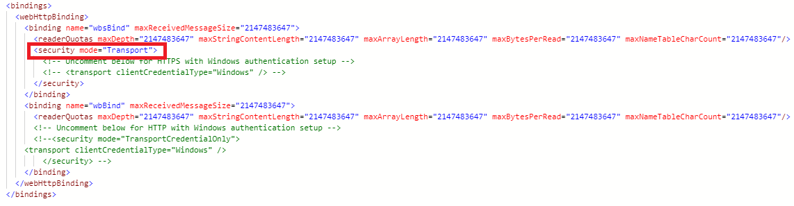

  5. Check the binding settings in the file web.config located at the SmartHub root level. Ensure the  <security mode="Transport"> line is uncommented, as shown below.

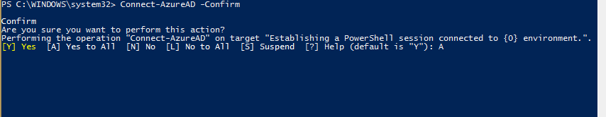

  5. Connect to Azure AD with the command Connect-AzureAD -Confirm as shown here:
