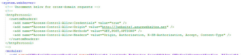

First, navigate to the web.config file and open it.
- Uncomment the section about cross-domain requests:
- Edit the value of the Access-Control-Allow-Origin and change it to the URL of your site.
Note: The URL cannot end with a "/" character.
Also, the URL must always start with the protocol ("http" or "https") or * to allow any domain to make requests to the API.
Tip: Even though * is a valid Origin value, it is not the best practice. There is no alternative way in the header specification to provide comma separated values for multiple domains.
BA Insight recommends you follow the steps in the section Enable Cross-domain Requests for Multiple URLs, which enables you to specify specific domains that are allowed to make the cross-domain requests to the API.

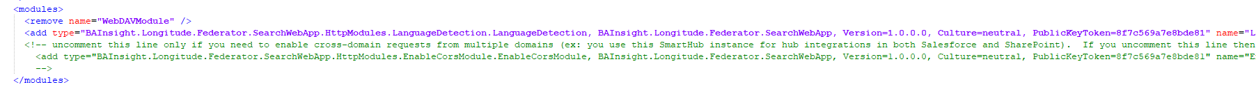

To support multiple URLs for Cross-domain request:
Open and modify the file web.config
EnableCorsModule:
