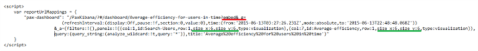

  • Enter the link to the pax-dashboard in the reportUrlMappings object:
    1. Provide the link starting with dashboard/ and concatenate this link with /PaxKibana/?#/ so that the URL rewrite will work.
    2. Make sure the size of the dashboard is set above (12x6).
    3. To embed the dashboard, you must add the embed& tag in the provided link before _g=;
      1. For example: /PaxKibana/?#/dashboard/Distribution-of-actions-with-this-document?embed&_g…).
    See the script example.

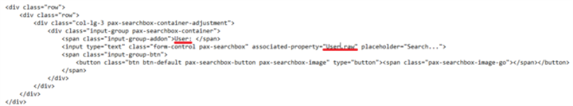

  • To display a search box on the new reporting page, you must add/keep the pax search container.
  • Replace the input-group-addon value with the title of the field that you want to search for and the associated-property value to search.
    See the sample code.
