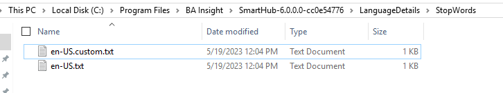

Modify StopWords Files
The default files are overwritten every time SmartHub is updated, therefore if you want to modify them, take the following steps:
  1. Create a copy of the file.
  2. Rename it to <language-code>.custom.txt
  3. Modify the new file.
Example
For example, to add or remove stop words for the English language:
  1. Copy the file en-US.txt.
  2. Rename the file to en-US.custom.txt
  3. Modify the file as you desire.
StopWords are cached for 24 hours, therefore every time you modify the StopWords files you have to perform an iisreset
