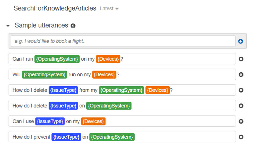

SearchForKnowledgeArticles Intent Example
- In the example below, the intent "SearchForKnowledgeArticles" is shown.
- Every line contains anutterance.
- Slots in each utterance are highlighted in different colors.
- Note that slots such asIssueType,OperatingSystem, andDevicesare a kind of keyword that can be by your app.

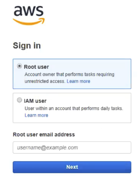

How to Create a Root/IAM User Account
In the following topics, you will use on of two available AWS user accounts:
- Root user:
- Account owner.
- Unrestricted access
- IAM user:
- Standard user.
- Restricted .
- The App Key and App Secret (topics described below) are generated for each IAM user.
To create an account, go to aws.amazon.com and follow the instructions on the page.

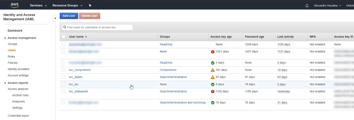

Set User Account Security
- To set the security access for each IAM user account, from console.aws.amazon.com, navigate to IAM > Users > <user_account> > Security Credentials.
- Click the Add user button to create a new user.
- Set the user's access as desired. Repeat with other users as appropriate and necessary.

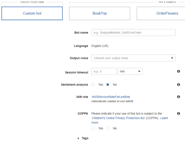

- Create a new (Custom) Bot. Under Bots, click Create > Custom bot.
- Fill in the Bot fields including "Bot name."
- Click the Create button.

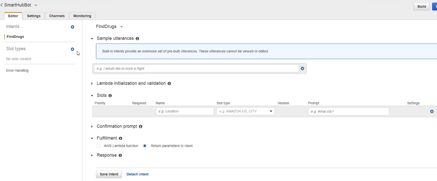

Configure Your AWS Lex Bot with Intents
Use the steps below to configure your AWS Lex bot.
See AWS Lex documentation for more information.
The "Support" drop-down menu in the top right also provides links to additional materials and training.
- To configure your bot with an intent, click the "+" icon next to on the left side menu.
- In the example below, "FindDrugs" is the example intent.
- Next, configure your intent with utterances.
- Complete the remaining fields as desired.
- Click Save Intent.
- Enter as many intents as you desire.

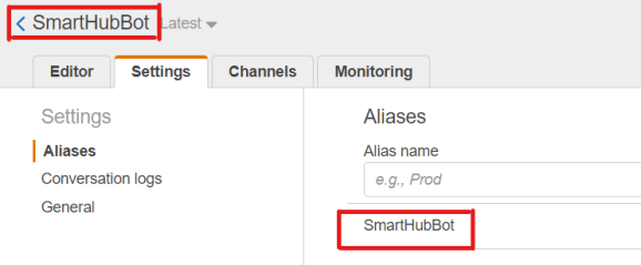

How to Get Your Bot Name and Bot Alias
For the Bot Name and Bot Alias fields:
- Go to http://console.aws.amazon.com and under Services search for Amazon Lex.
- Select an existing bot from the list or create a new one.
- Click Settings > Aliases.
- The Bot Name and Bot Alias are shown in the screenshot below:
