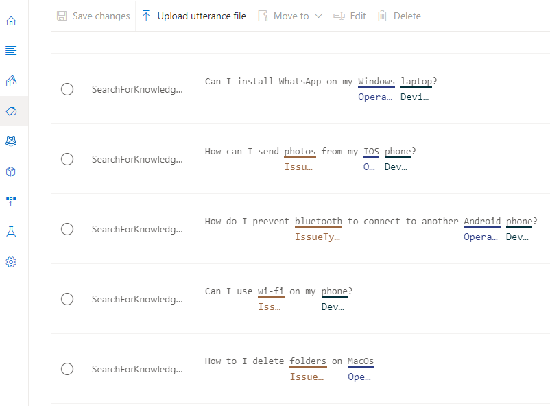

Examples
SearchForKnowledgeArticles Intent Example
  • In the example below, the intent "SearchForKnowledgeArticles" is shown.
  • Every line contains an utterance.
  • Entities in each utterance are highlighted in .
  • Note that entities such as IssueType, OperatingSystem, and Devices are a kind of keyword that can be recognized by your app.

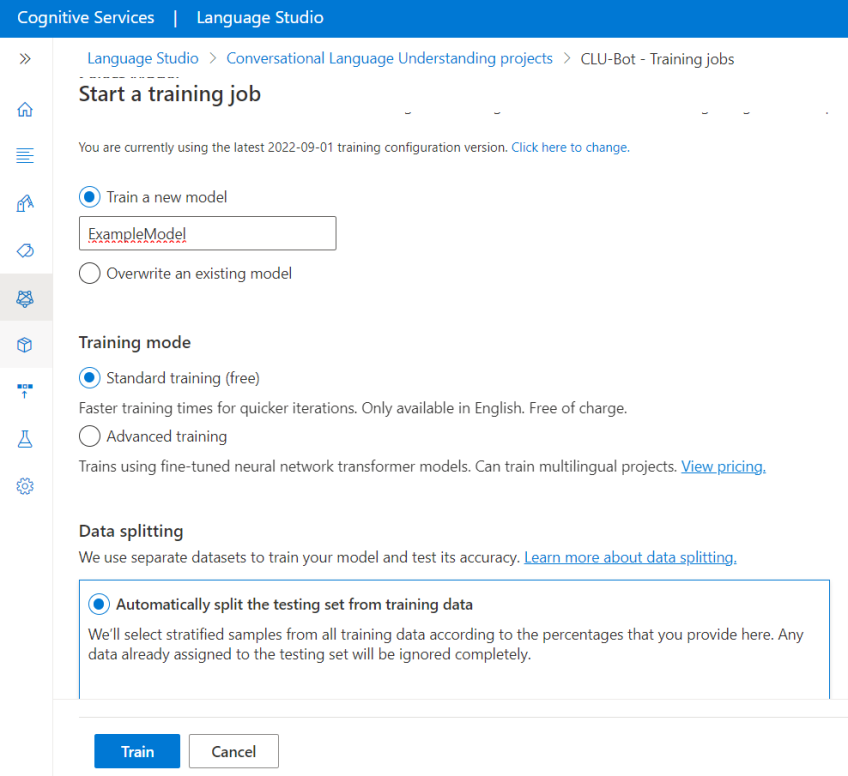

How to Train your CLU App
  1. Select Training jobs from the left menu.
  2. Select Start a training job
  3. Enter a model name
  4. Select Train

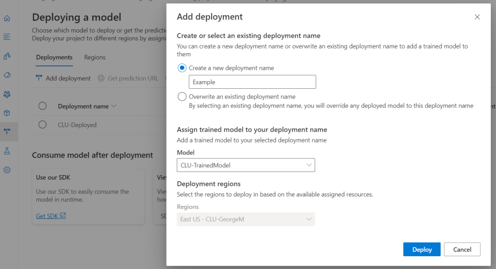

How to Deploy your CLU App
  1. Select Deploying a model from the left menu.
  2. Select Add deployment
  3. Enter a deployment name
  4. Select your trained model from above step
  5. Select Deploy
