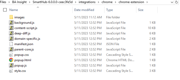

  2. Open the JavaScript file content-script.js at \integrations\chrome\chrome-extension\.

  7. Click "Load Unpacked" (top left side of the page) and select "...\integrations\chrome\chrome-extension" (you may move the "chrome-extension" directory anywhere on your drive).
