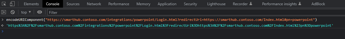

Example
<bt:Url id="Upland.Taskpane.Url" DefaultValue="https://smarthub.contoso.com/integrations/powerpoint/Login.html?redirectUri=https%3A%2F%2Fsmarthub.contoso.com%2Findex.html%23pn%3Dpowerpoint" />
https://smarthub.contoso.com/integrations/powerpoint/Login.html?redirectUri=https://smarthub.contoso.com/Index.html#pn=powerpoint
URLs can be encoded by opening a Browser Console (F12) and applying encodeURIComponent function to desired URL:

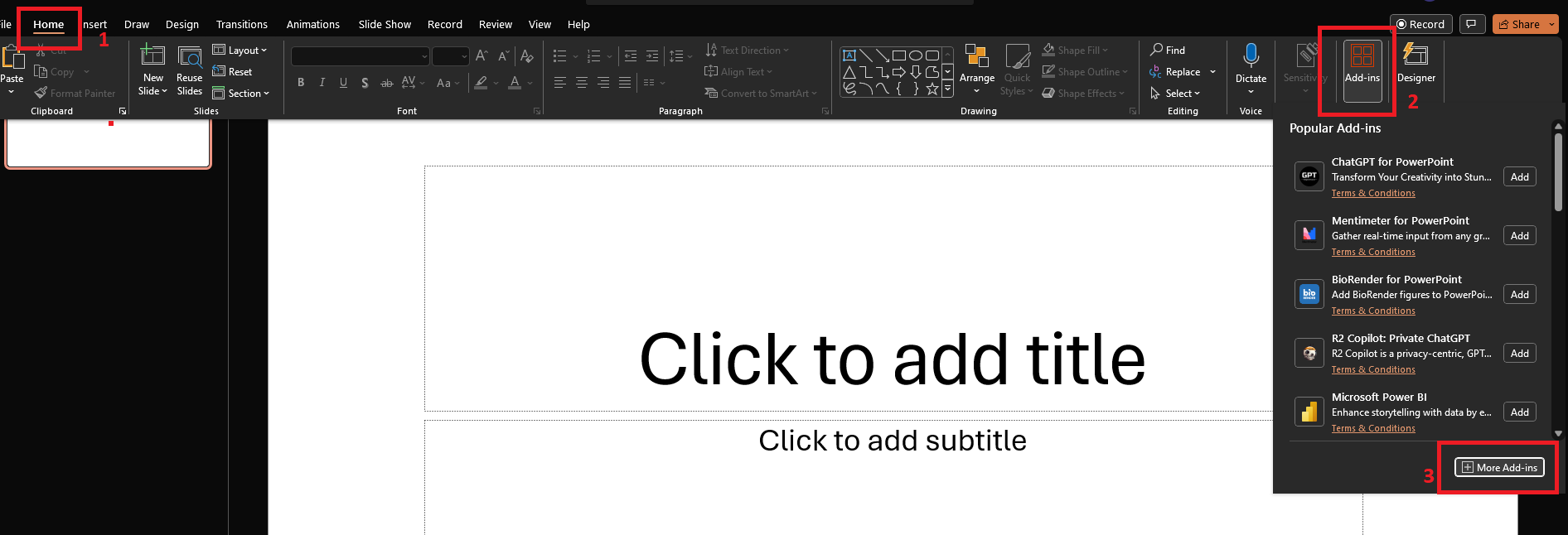

How Users Enable SmartHub in PowerPoint
Users can enable SmartHub in their PowerPoint instance by going to Home > Add-ins > More Add ins > Admin managed and add "SmartHub ".

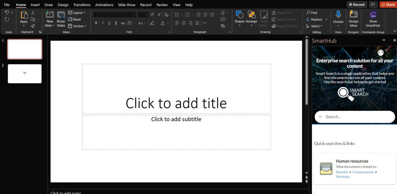

The SmartHub button can be found in PowerPoint > Home > Show SmartHub.
