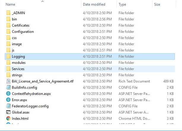

How to Access the Log Files
The log files are located in the logging folder of the SmartHub directory.
See the following graphic.
See the Logging folder.

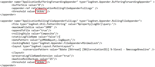

How to Change the Log Level
  1. Use a text editor to modify the FederatorLogger.config file in your SmartHub folder.
  2. Change all of the threshold values from WARN to one of the following levels:
    • INFO
    • ERROR
    • DEBUG
 See the DEBUG log level.
