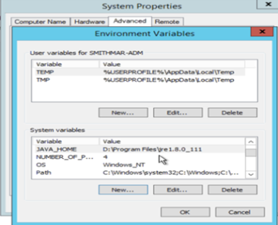

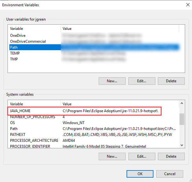

- Add a new system variable:
JAVA_HOME. - Specify the path to the Java install directory (root of
/lib /bin):

JAVA HOME: During installation, select the Custom Setup options shown below:
- Specify the path of the JAVA_HOME variable:

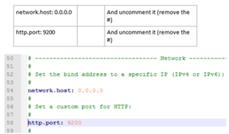

- Set the following properties in the YML file
\config\elasticsearch.yml:- network.host: 0.0.0.0
Set the value to one of the following:- An IP address attached to an individual network device such as NIC.
- This IP address must resolve to your elastic server (or a DNS which does).
- Once set, you can only access Elastic through this network interface device.
- 127.0.0.1 to make elastic accessible from this server only by using "localhost"
- 0.0.0.0 to make elastic accessible from any address/IP.
- http.port: 9200: Leave this set at the default value of 9200
- discovery.type: single-node: Set this property if you are using a single server for your elastic instance.

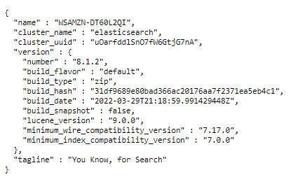

Verify the Elastic node status by going to http://localhost:9200.
Note: You must have an instance of Elasticsearch up and running.
Make sure that JSON is loaded.
For example, see the following capture:

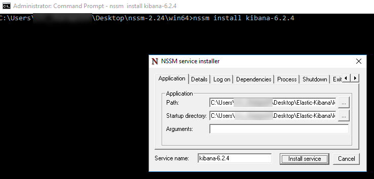

To install Kibana as a Windows service, follow these steps:
Go to the Kibana Download page, download and unzip the file.
Go to the NSSM Download page, download and unzip the file.

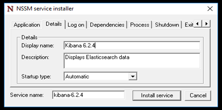

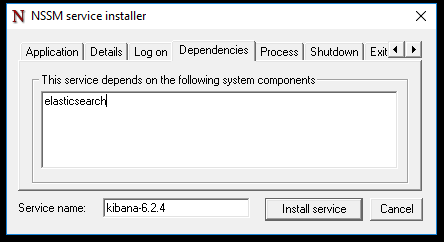

Use the command prompt with administrator permissions to navigate to the folder which contains nssm.exe:
cdpath_to_nssm/nssm-2.24/win64orpath_to_nssm/nssm-2.24/win32 -
Run the command (version 7.0 used, for example purposes):
nssm install kibana-7.0.0In the "NSSM service installer" window:
Applicationtab: Set kibana.bat as Application Path (screenshot shown for example purposes only)

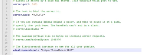

- server.port:
5601 - server.host:
"0.0.0.0" - server.host
:"0.0.0.0"
- server.port:

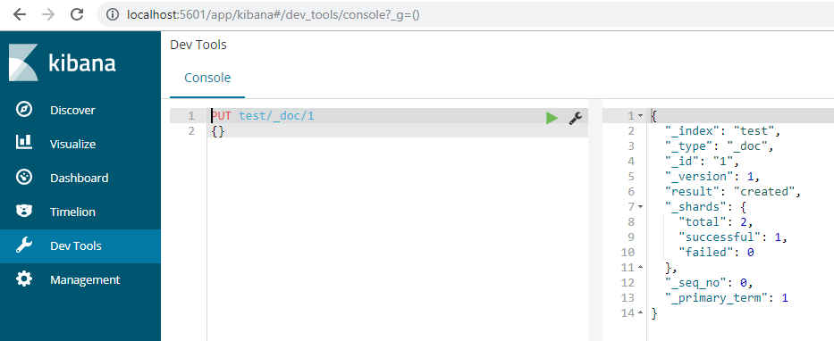

- Kibana Prerequisites:
In this version of Kibana, use the following additional steps:- Go to your Kibana console and open the Dev Tools tab:http://localhost:5601/app/kibana#/dev_tools/console?_g=()
Run this command:PUT test/_doc/1{}

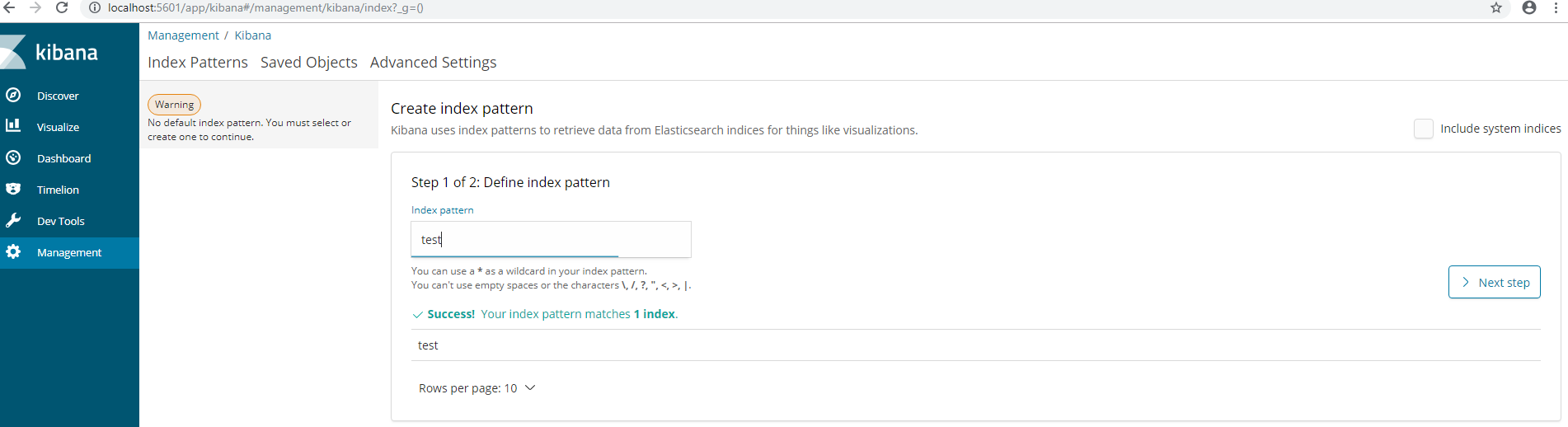

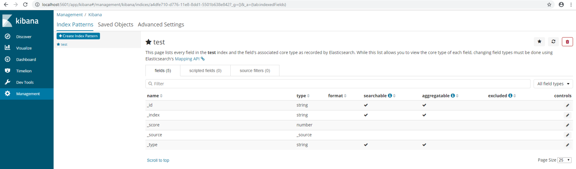

Open the Management tab →Index Patterns.
Create an index pattern based on index:
After SmartHub Analytics installation, you can delete the index-pattern and index.
Go to Kibana address → Management → Index Pattern → delete the "
test"index pattern.

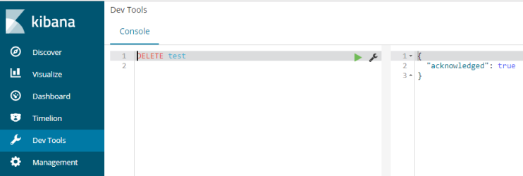

Go to Kibana address → Dev Tools. Write in console "
DELETE test"to delete index.
