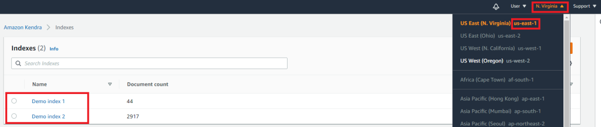

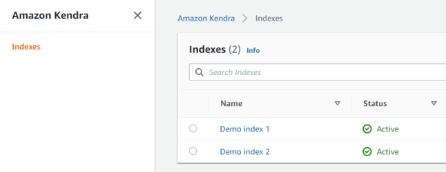

- Index name: The name of the AWS Kendra index to be used at search time. This name is located in the Kendra management page.

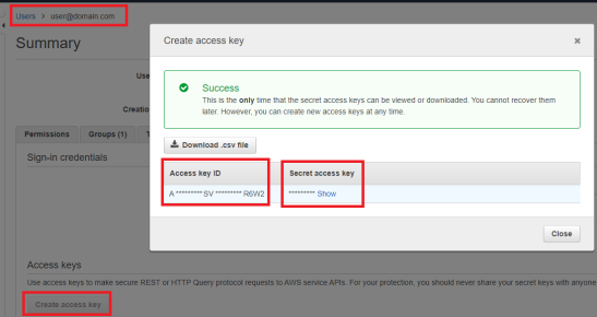

Access Key: The IAM Access Key to be used at search time for authorization.
This is located in the IAM management page.
- Secret Key: The IAM Secret Key to be used at search time for authorization (see screenshot above).
- Region: The Region where the AWS Kendra instance is hosted. You can find this in the Kendra management page.
