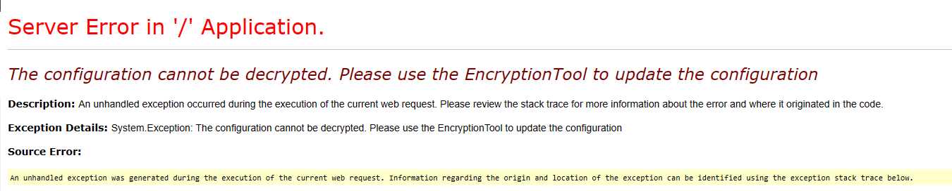

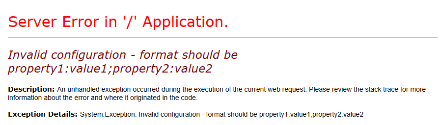

Common Errors
The following errors indicate that the configurations have not been upgraded. See How to use the SmartHub Encryption Tool to change the encryption keys, above.
This error message usually indicates that the environment variables are configured, but the current configuration uses an obsolete encryption key.
This error message usually indicates that the environment variables are not configured, and the current configuration uses an obsolete encryption key.
