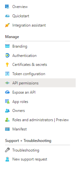

  4. Click the "API permissions" entry from the left side navigation menu.
