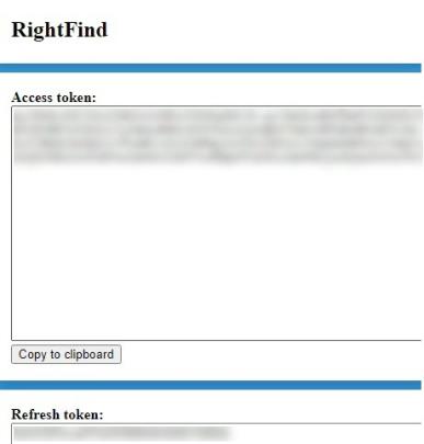

- Click Get Access Token. You are redirected to a newly opened web page.
- Click Copy to clipboard to copy the access token .
- Go back to the search engine Configuration page and paste the access token in the Access Token field
- Repeat steps 6 and 7 for the Refresh Token.
- Click Save.
- Close the web page opened during the authentication process.
