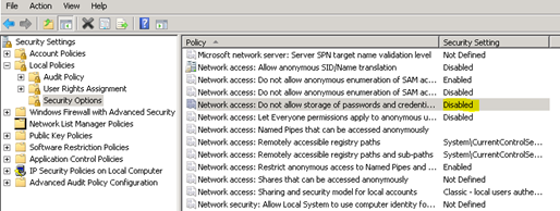

Security Settings
Disable Network Access setting
  1. To open Local Security Policy, on the Start secpol.msc.
  • Local security policy:
    • Disable the Network access setting "Do not allow storage of passwords and credentials."
    • This is the default Windows setting.
