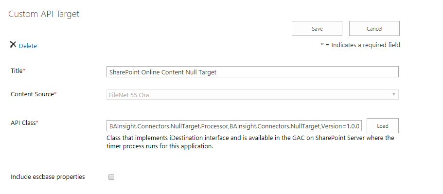

- Navigate to the "Targets" tab.
- In the "Add New" drop-down list, select "Target Custom API".
- The page re-loads (with the form) to create a new Target.
- Enter a name for this Target configuration.
- Select the Content Source for which you want to generate previews.
- Provide the following in the field API Class, and then click Load:
BAInsight.Connectors.NullTarget.Processor,BAInsight.Connectors.NullTarget,Version=1.0.0.0, Culture=neutral, PublicKeyToken=9e27a9d745350a59 - Leave the rest of the settings as their defaults.

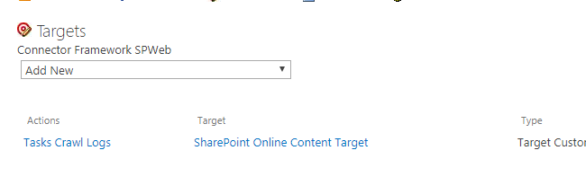

- Click "Save".
- When complete, your new Target is listed within the Targets tab.

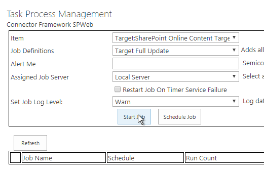

Start a Target Full Update Job
Start a Target Full Update job on the Target to generate previews.
- From the Targets page, click the "Tasks" hyperlink next to the Target you wish to run the synch on.
The Task Process Management page opens. - The Item field is already populated with the correct Target.
- Leave this value as is.
- In the Job Definitions field select "Target Full Update" from the drop-down menu.
- Leave the other options as their defaults and click "Start Job".
- The Target processes the items from the Content Source.
- This passes documents off to the Preview CEWS for preview generation.

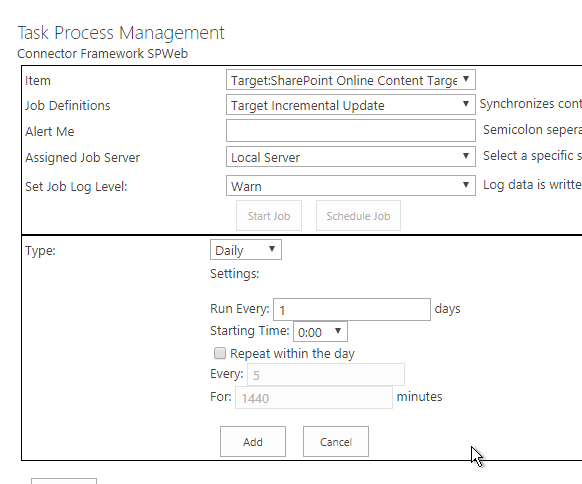

Scheduling Regular Incremental Updates
Once the Full update is complete, schedule regular incremental updates to generate previews for any newly added or modified documents:
- On the Targets page, click the "Tasks" link next to the Target you wish to run the synch on.
- In the Job Definitions field select "Target Incremental Update" from the drop-down menu.
- Leave other options as their defaults and click "Schedule Job."
- Schedule your incremental updates to run on the interval you desire by using the settings provided.
- To schedule the job, click "Add" when you are done.

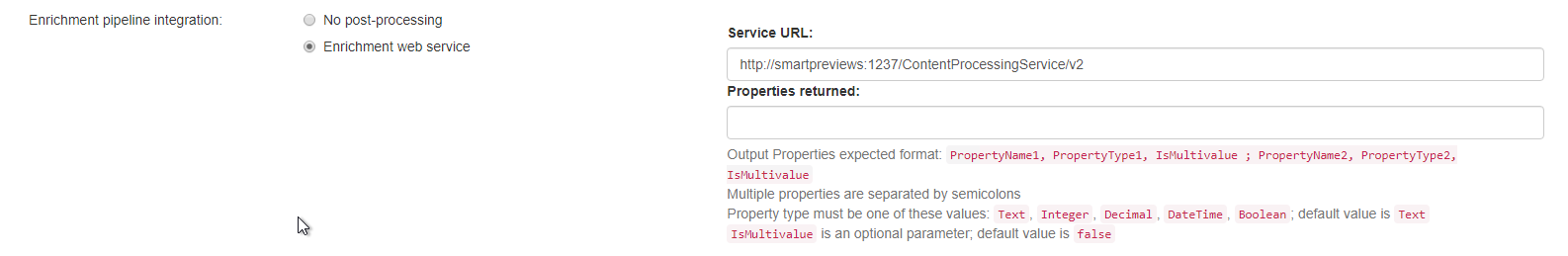

- In the Connectivity Hub user interface, edit the Content Source for which you want Previews.
- In the Advanced tab, in the "Enrichment Pipeline Integration"section and select Content Enrichment Service.
- Add the URL to your preview generation service.
- This service runs on the server where the Smart Previews Import server is installed.
- Enter the URL in the format below.
- Note that you can use the exact URL below if you replace "servername" with your own.
http://servername:1237/ContentProcessingService/v2
