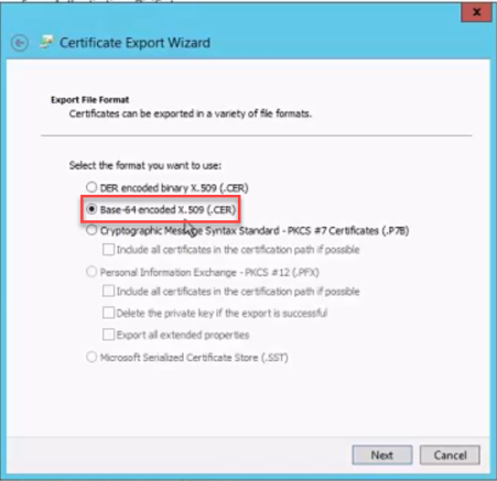

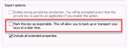

  • If you use another program, such as IIS, when you export the certificate, ensure you do not mark the key as exportable:
  • Also, when exporting your certificate using IIS, note that it MUST BE Base-64 encoded:
