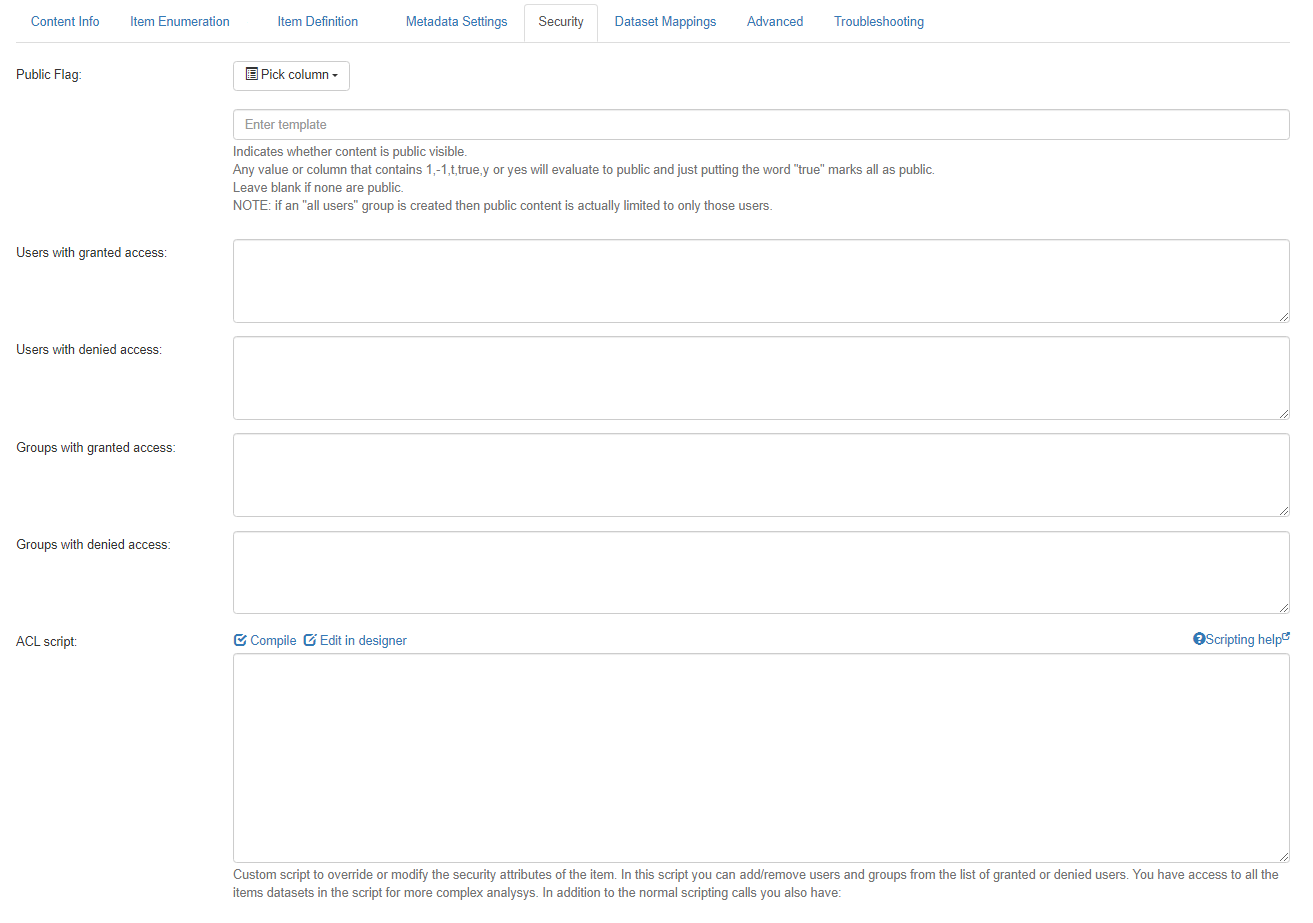

  1. In Connectivity Hub, open your SQL Content Source for editing..
  2. Click the Security tab.
  3. Public Flag:
    1. Choose the column that indicates whether content is publicly visible.
    2. Any value or column that contains 1, -1, t, true, y, or yes evaluate to public, and entering true marks all as public.
    3. Leave blank if none are public.
    4. The effect of an item being marked as public can vary depending on whether you have created an 'All Users Group'.
    5. See How to Configure Active Directory for Your Connector.
  4. Users with granted access:
    Enter the SQL statement that returns the list of user IDs that have permission to access this item.
    1. SPW_USERID: Required column.
    2. [SPW_ID]: Required parameter.
    3. [SPW_SUBID]: Optional parameter.
    4. Place the character @S_ or @I_ in front of a variable to indicate String or Integer value.
      • For example, @S_SPWID.
  5. Users with denied access: Enter the SQL statement that returns user IDs of users that are specifically denied access to the system.
    • SPW_USERID: Required column.
    • [SPW_ID]: Required parameter.
    • [SPW_SUBID]: Optional parameter.
    • Place the character @S_ or @I_ in front of a variable to indicate String or Integer value.
  6. Groups with granted access:
    Enter SQL Statement that returns group IDs of groups or roles that have permission to access the item.
    • SPW_GROUPID: Required column.
    • Place the character @S_ or @I_ in front of a variable to indicate String or Integer value. For example, @S_SPWID.
  7. Group with denied access:
    Enter the SQL statement that returns the list of group IDs that are specifically denied access to this item.
    This overrides Grants.
    • SPW_GROUPID is a required column.
    • [SPW_ID] is a required parameter.
    • [SPW_SUBID] is an optional parameter.
  8. ACL Script:
    1. Enter VBScript to override or modify the security attributes of the item.
    2. In this script you can add/remove users and groups from the list of granted or denied users.
    3. You have access to all the items datasets in the script for more complex analysis.
    4. For more information, see VB.Net Scripting.
