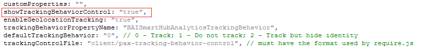

- Administratorscan specify tracking behavior using the
SH.Analyticssettings in the modules/SmartHubResourceLoader/DefaultModuleSettings.jsfile. - Copy the settings described below into your custom settings file, such as CustomResultsSettings.js for your custom Results.html page.
- Modify the settings as you see it. DO NOT modify the DefaultModuleSettings.js file. It is overwritten at upgrade time.
- If administrators choose not to show the tracking behavior control on SmartHubpages, the value of the
defaultTrackingBehaviorsetting will be used as the tracking behavior for all users.
By default, defaultTrackingBehavior is set to "0" in the DefaultModuleSettings.jsfile:
0 - Track activity(default): All queries and selections are tracked and associated with the name of the user.1- Do not track: No information is recorded.2- Track but hide identity: All actions are monitored, but no personal data is associated with the tracking. SeeUser Profile mappings.After you change the "
showTrackingBehaviorControl" to "false," wait 10 minutes (let the sync to run two times) and then delete and recreate the paxindex. This way you ensure that you don't have old records in your reporting site.
- If administrators choose to show the tracking behavior control on SmartHubpages, the tracking behavoir will be the one specified by the user in the UI.

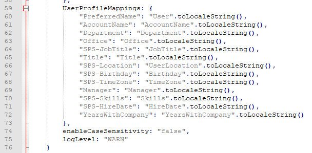

User Profile Settings
In order to use the tracking option, you must configure your user profile settings.
These settings determine which users have their actions tracked.
SmartHub Analytics calls the User Profile Service to obtain the profile details. Some of these properties (details) are saved in the index.
The information that is stored in the index appears as User Analytics reports.
View Hidden Identity Values for Tracked User Operations with Hidden Identities
See the User Profile mappings from the DefaultModuleSettings.js file below.
- The file format is set as:
"User Profile Property Name": "Analytics internal mapping name" - The property name from the User Profile appears on the left side of the colon ':' on each line.
- The Analytics internal mapping name appears on the right side, after the colon ':' on each line.
Hidden User Identities
For each User Profile property (such as Department, Job, or Location): if a user chooses to track operations, but to hide their identity, a unique value appears, such as Anonymousasda43dsad5.
See the properties in the Reporting site, shown here:
