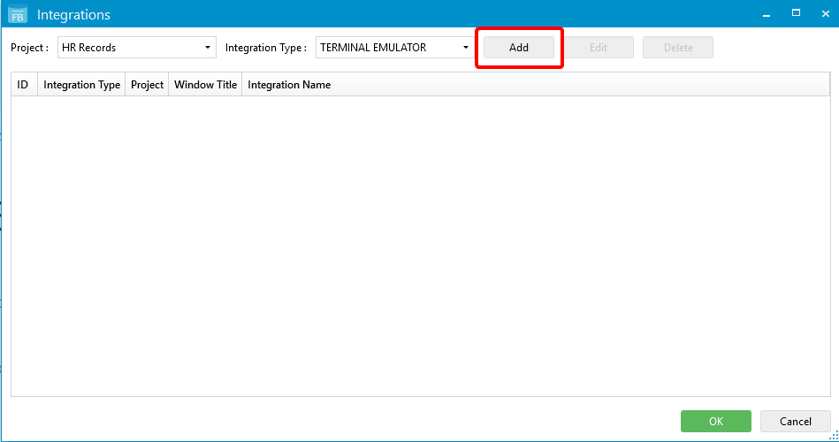

Add a terminal emulator integration
  1. On the Integration menu, click Setup.
  2. In the Project list, select a project that you want to configure the integration for.
  3. In the Integration Type list, select TERMINAL EMULATOR.
  4. Click Add.

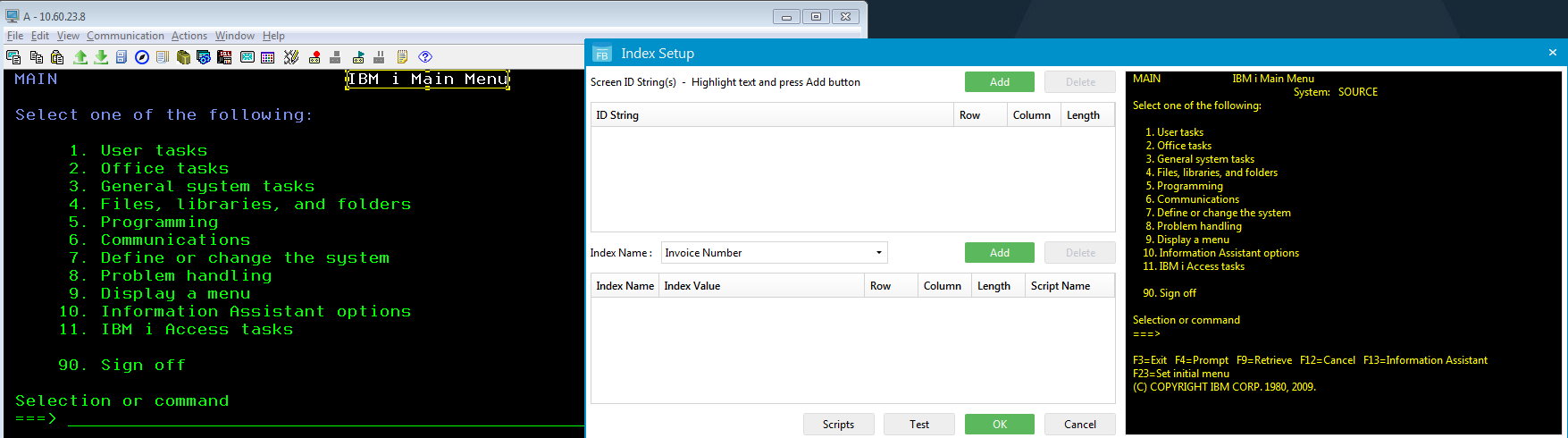

  5. Sign in to AS400 Emulator.
    Note: You need to be connected to the Sophos SSL VPN Client.
  6. Select the AS400 Terminal Emulator window.
    The Index Setup dialog box is populated with data from the AS400 Terminal Emulator window.

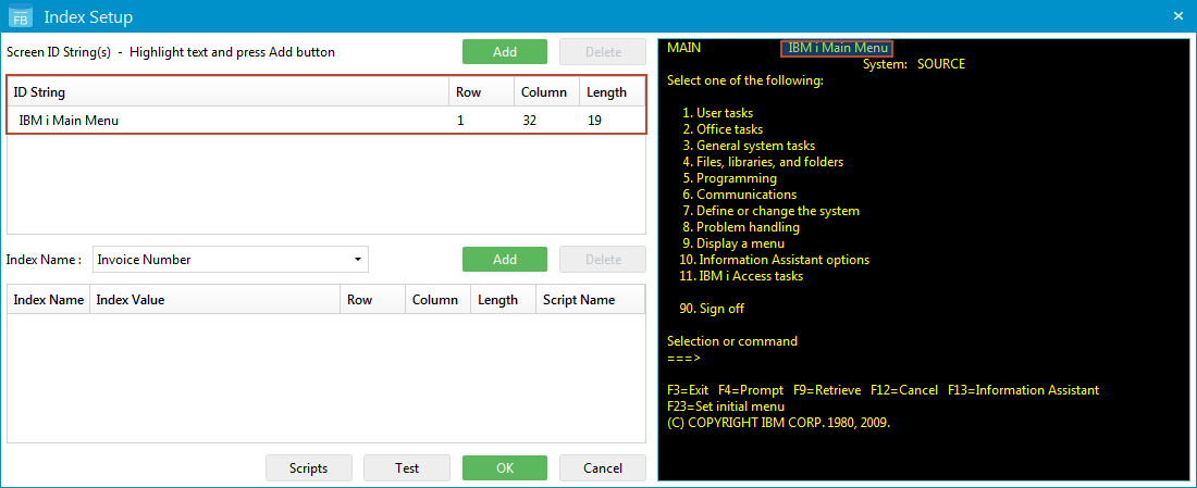

  7. Highlight any area, and then click Add in the Index Setup dialog box.
    The highlighted area is displayed in the ID String.

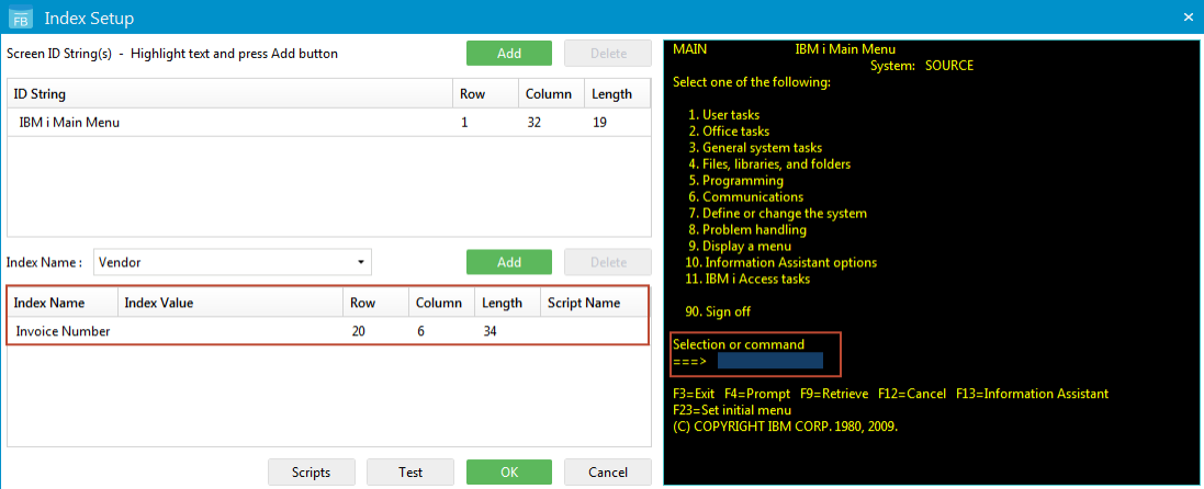

  8. In the Index Name box, select the index field of the project, and then click Add.

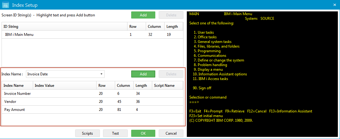

  9. Highlight the area after the previous selection, and then click Add.
  10. Repeat this until you cover all the index fields of the project.
    Click Test to ensure that the mappings return the expected values.
