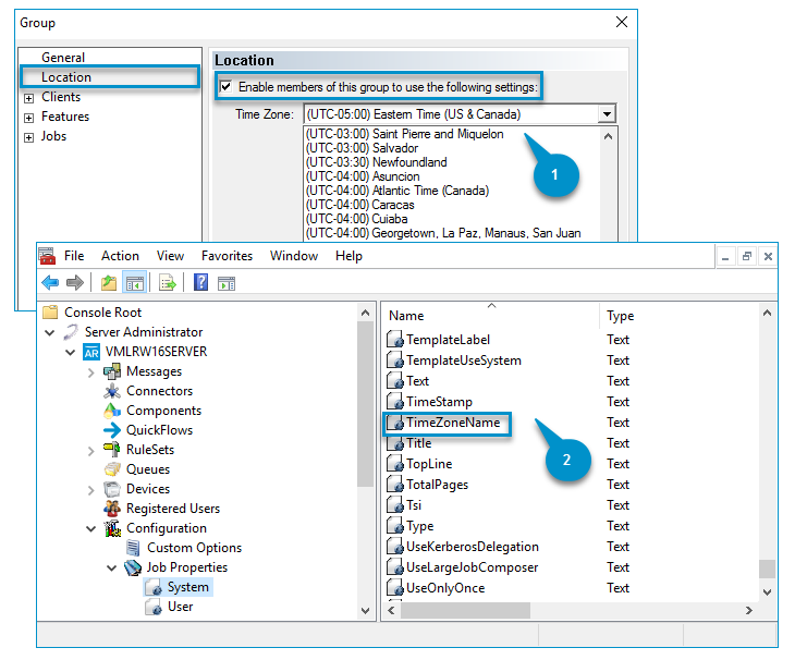

Group-specific Time Zones at a Glance
Group-specific Time Zones Legend |
Description |
1. Group Properties dialog box |
Use the Group Properties > Location setting to enable members of a specific group to use the time zone selected. |
2. Job Properties > System > TimeZoneName |
Used by the server to verify the appropriate Group > Location setting, and date and time zone variables are applied to specific groups and their workflow cover page, fax top line, and email notification templates. Note: This happens behind the scenes and does not require any additional configuration. |
