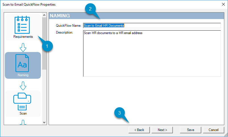

You can use the QuickFlow Wizard to configure workflows based on your company’s requirements. The wizard is also used to edit QuickFlows. See Edit a QuickFlow for more information.
See the QuickFlows Wizard below.
QuickFlows Wizard at a Glance
QuickFlows Wizard  Legend
Description
1. QuickFlows Wizard navigation pane with icons
Use the icons to go back or to the next step in the wizard.
2. QuickFlows Wizard step pane
Use the QuickFlows Wizard step pane to:
  • Identify the step you are working on.
  • Specify QuickFlow details and properties.
3. QuickFlows Wizard navigation buttons
Use the buttons to:
  • Go back to the previous step.
  • Go to the next step in the wizard.
  • Save the QuickFlow.
  • Cancel the QuickFlow without saving, if necessary.
