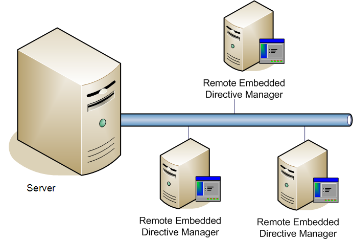

The server shown here does not have a local Embedded Directive Manager, but has three Remote Embedded Directive Managers.
(This is an example of a supported configuration. The server can have a local Embedded Directive Manager and an environment can have more or fewer Remote Embedded Directive Managers than shown in this illustration.)
