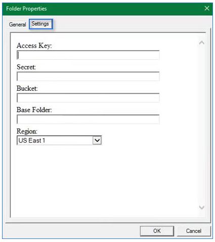

  2. Select the Settings tab.
See the Folder Properties > Settings dialog box example below.
  1. Specify the access key in the Access Key box.
  2. Specify the secret in the Secret box.
  3. Specify the bucket in the Bucket box.
  4. Specify the base folder in the Base folder box.
  5. Specify the region in the Region box.
  6. Click OK.
Note: The HP CR Server attempts to validate the AWS S3 Bucket based on the parameters you specified. A Failed to apply properties error message will appear if it cannot validate the Base folder. Review and edit your parameters if this occurs.
