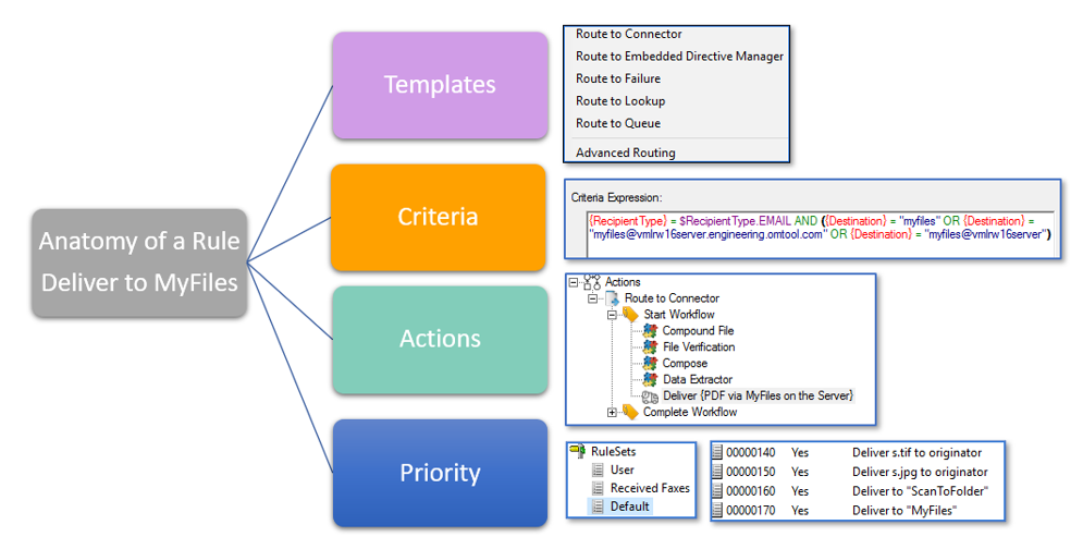

Rules consists of templates, system or user-defined job properties and values formulated into criteria and actions which are prioritized. Rules can be configured to use templates or job properties.
Let us take a look at the “Deliver to MyFiles” rule located in the Default RuleSets folder. This rule is used as an example for illustrative purposes and may not be applicable to your unique workflow requirements.
The MyFiles folder is a personal folder that a user scans and convert documents to and from the HP CR Client application or device.
Deliver to MyFiles Rule at a Glance
Understanding the Deliver to MyFiles rule
Rules in the Default RuleSets folder are automatically created for you during the server installation based on your workflow configuration. The Route to Connector template is used as the foundation for the Deliver to MyFiles rule. The template contains the preliminary job properties and actions needed for the rule.
The Recipient Type and Destination job properties are included in the rule and shown in the Criteria Expression window with the appropriate syntax and values. The AND/OR operators are used in the expression to include additional parameters and values as needed.

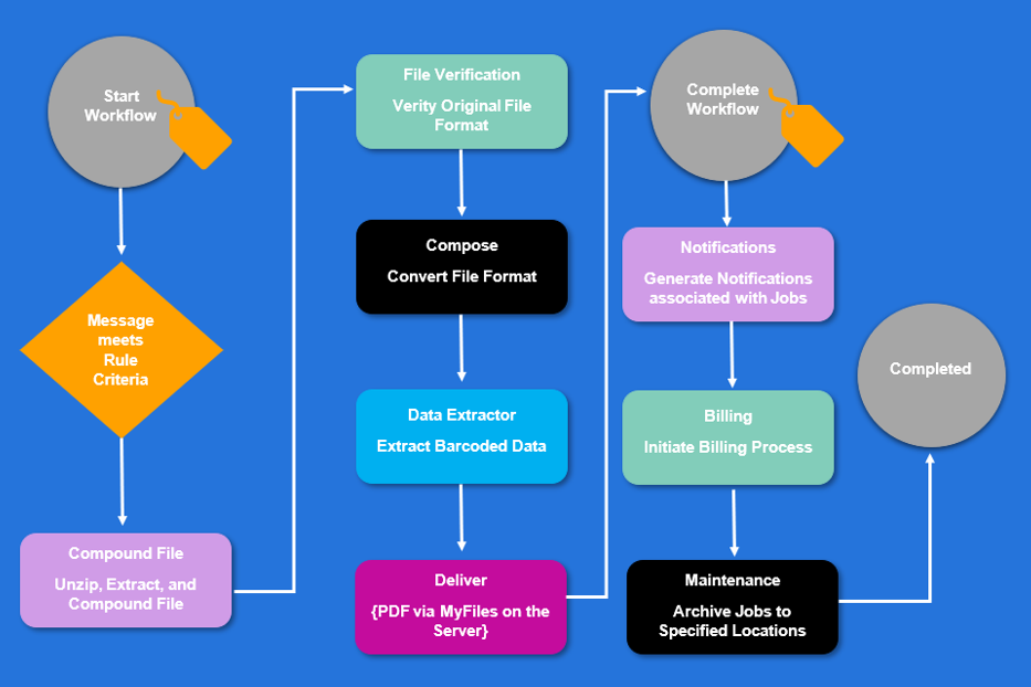

The Actions tree is a visual representation of the template’s workflow, and it includes the following tags and actions. The actions are process steps that take place during the routing of a message prior to and after delivery.
Note: Some of the actions may initiate other processes based on your workflow requirements.
Start Workflow
Compound File – Zipped files are unzipped, extracted, and then compounded.
File Verification – The original file format; for example, PDF, is verified that the format remains intact.
Compose – The original file format is converted to a different format if required.
Data Extractor – Bar-coded data is extracted during this action step if used.
Deliver {PDF via MyFiles on the Server} – The PDF is delivered to a user’s MyFiles folder.
Complete Workflow
Notifications – Standard or custom notifications are sent based on Client applications and user requirements.
Billing – For configurations that use the Billing component only. The Billing component initiates a billing process based on a company’s requirements.
Maintenance – This action takes place if Archiving is configured. The job is archived to specified locations, for example, a folder, database, or both.
See the Route to Connector Flowchart example below.
