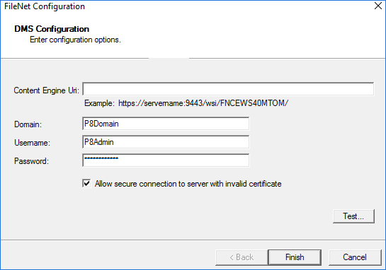

Select FileNet. The FileNet and DMS Configuration dialog box appears.
See the FileNet and DMS Configuration dialog box example below.
Specify the following parameters in the appropriate boxes.
Content Engine URI – FileNet installation web address
Domain – Hierarchical element where the connector will deliver to
Username – FileNet Administrator username
Password – FileNet Administrator password
Select Allow secure connection to server with invalid certificate only; for example, Self-signed certificates and useful for testing purposes.
Select Finish.
Note: For security reasons, it is recommended that you do not select this option.

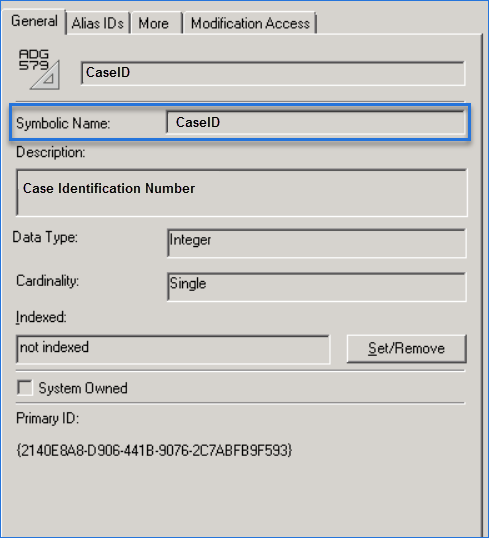

Metadata user-defined job properties
Every FileNet installation has a document class that contains metadata field definitions saved with a document. If Administrators want the FileNet connector to apply data to the metadata fields, they must create user-defined job properties for the metadata fields. FileNet Content Manager may display user-friendly names for the metadata fields, but symbolic names must be used to create the job properties in the Server Administrator. Metadata user-defined job properties are also case-sensitive.
Use the steps listed above to create the metadata user-defined job properties.
See the FileNet metadata field definition CaseID example below.
Note: You must use the name that appears in the Symbolic Name box when creating metadata job properties in the Server Administrator.

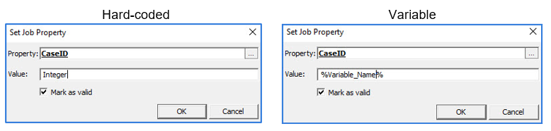

See example below.
This example shows a Document class named MyDocument with the following metadata fields defined in FileNet Content Manager.
Metadata Field CaseID – Integer
Metadata Field A – Boolean
Metadata Field B – Date/Time
Metadata Field C – Float
Metadata Field D – String
The metadata fields in the example above are hard-coded, but the values can be substituted with variables. For example, the Integer value can be substituted with a pre-defined variable .
See the Set Job Property > Value dialog box example below.
