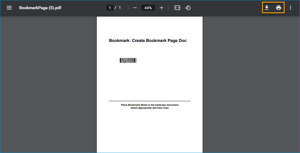

See the bookmark example below.
  1. Print the bookmark page.
  2. Select Close.
  3. Place the bookmark page(s) in your document and scan.
Note: You can have multiple bookmarks in a document. Create additional bookmarks for your document as needed by repeating the steps above.
Saving a bookmark
You can save a bookmark for reuse by using the Download arrow in the PDF window. Save the bookmark after the download has been completed to your preferred location.
