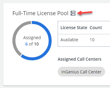

High Availability Licensing
High Availability is a paid feature. If you wish to inquire more about purchasing a High Availability license, please contact (missing or bad snippet).
When High Availability has been activated on your account, verify that the feature has been enabled from the Licensing page. An icon is displayed next to the license pool title to indicate High Availability support, as shown in the following image:

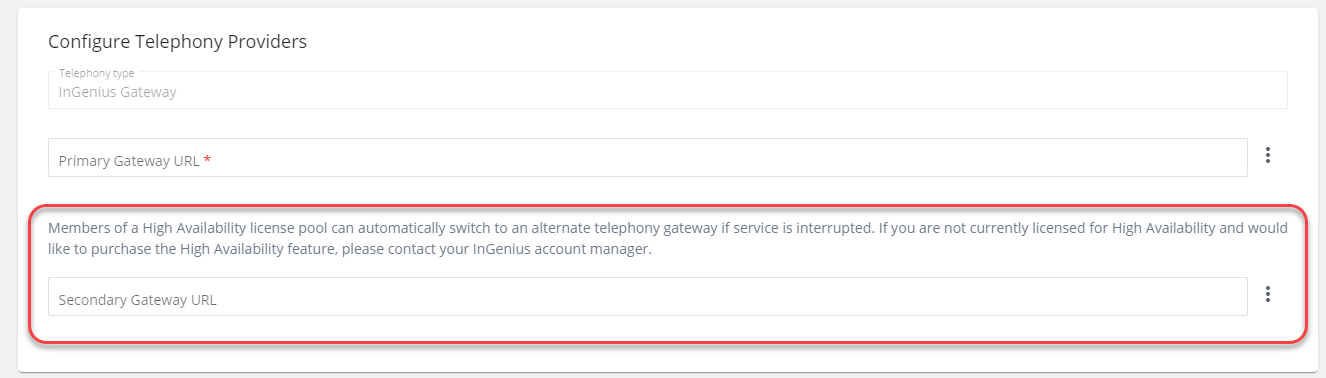

How to Add a Secondary Gateway URL
To add a secondary gateway URL:
  1. Navigate to the Telephony page in the InGenius Admin App.
  2. If you have already created a gateway telephony provider profile, select it to navigate to the Telephony Provider page. If you have not created a profile, create a new one with the InGenius Gateway telephony type. Then, select the newly-created telephony provider profile.
  3. Copy and paste the secondary gateway URL into the respective field on the Telephony Provider profile page (field displayed in the image below):
Note: To retrieve your secondary gateway URL from the InGenius Configuration Tool, follow the steps described in the Configure Telephony Gateway Profile section. Ensure to copy and paste the secondary gateway URL from the Configuration Tool into the Secondary Gateway URL field.
