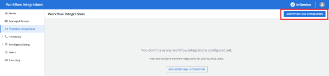

  1. In the Admin App, navigate to the Workflow Integrations page.

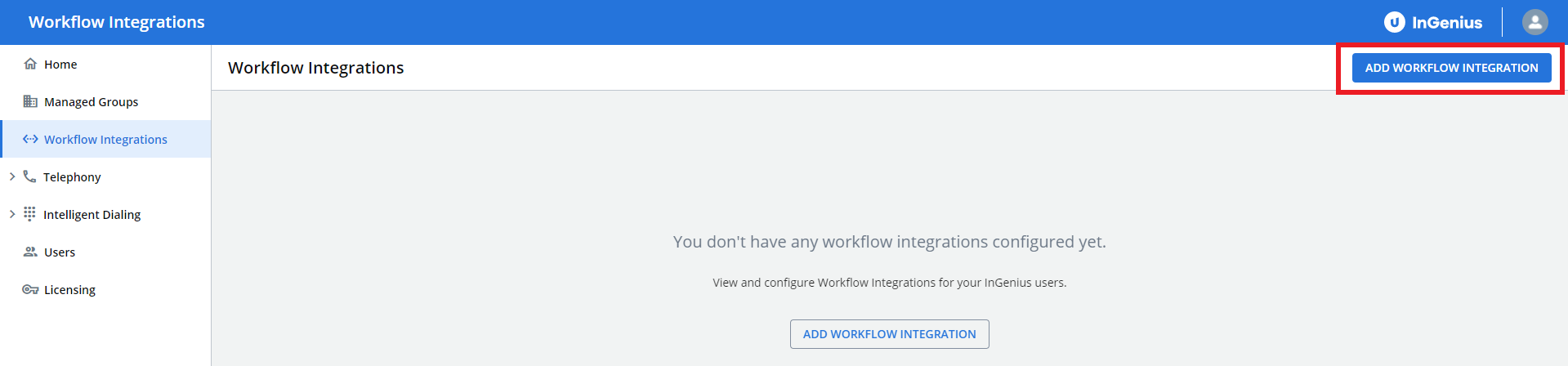

  2. Click the 'Add Workflow Integration' button on the top right corner of the page.
  3. In the Add Workflow Integration window, fill in an appropriate profile name and select 'Set Workflow Integration Name'

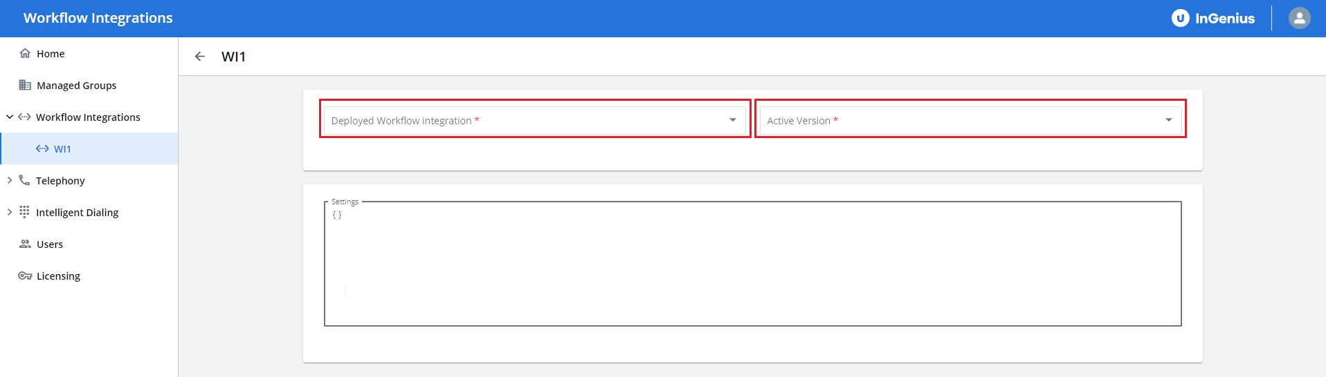

  4. In the profile page for the Workflow Integration you have created, select a Deployed Workflow Integration and an Active Version from the dropdown boxes.
    Note: If you cannot find a deployed workflow integration or active version, contact an InGenius specialist for help in configuration and deployment.
  5. Fill in the Settings field with your desired configuration.
    Note: There must be some setting in the field for the workflow integration to function, even for testing purposes.
  6. Select Publish Changes on the bottom left of the page.
