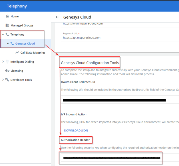

Genesys Cloud will require an Authorization Header to allow interfacing with the Upland Cloud. You will first need to obtain your security key from the InGenius Admin App before configuring the Authorization Header in Genesys.
Genesys Cloud Security Key
To obtain the security key required for configuration, follow the instructions below:
  1. In the Admin App, select the Telephony tab, and then select the telephony provider profile created for Genesys
  2. Navigate to Genesys Cloud Configuration Tools
  3. Underneath Authorization Header, select SHOW KEY if hidden
  4. Copy the displayed security key for use in the next instruction set.

  1. In the Admin App, select the Telephony tab.
  2. Navigate to your Genesys Cloud Telephony ProfileGenesys Cloud Configuration Tools.
  3. Underneath IVR Inbound Action, select DOWNLOAD JSON.

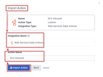

  4. Browse to locate your JSON file and select Import Action, configure the Import Action window as follows:
    Note: The Web Services Data Actions integration must be installed and activated in Genesys Cloud before importing the JSON snippet. Ensure this step is complete before proceeding. Refer to the Telephony Configuration page for more information.
    1. Select "Web Services Data Actions" as the Integration Name
    2. Type in "SCV Inbound" as the Action Name
    3. Select Import Action
  5. Select Save & Publish.
  6. Select Yes in the Publish Action popup that appears.

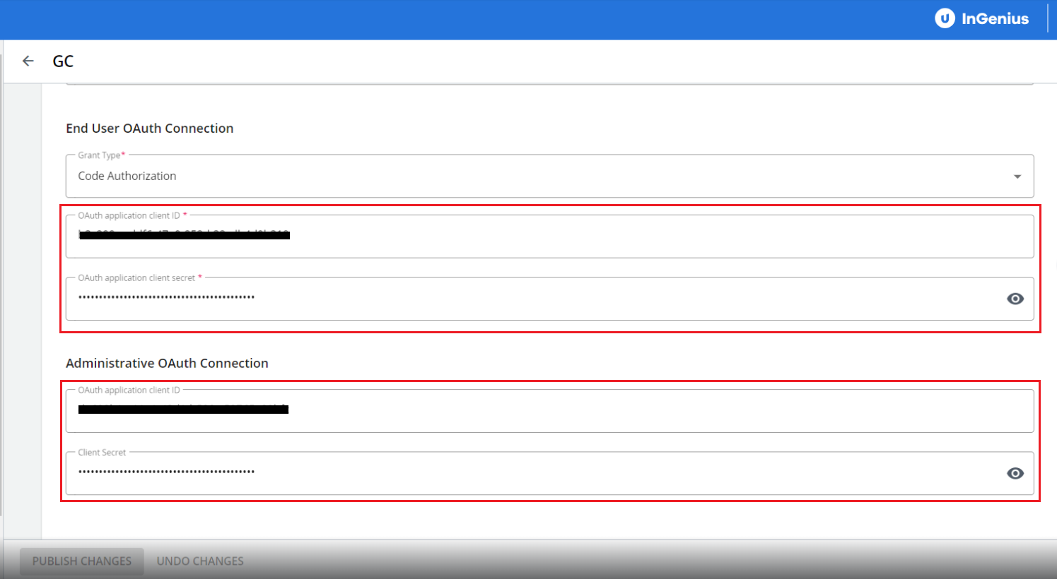

This section requires that you have created an OAuth Client in the Genesys Cloud Admin and recorded the Client ID, as detailed previously here.
  1. In the Admin App, return to the partially completed telephony provider profile you created for your Genesys telephony in the first step of this section.
  2. Under End User OAuth Connection, fill in the 'OAuth application client ID' field with the Client ID of the first Genesys OAuth Client you created in the previous section, the one with Grant Type - Token Implicit Grant.
  3. Under Administrative OAuth Connection, fill in the 'OAuth application client ID' and 'Client Secret' fields with the Client ID and Client Secret of the second Genesys OAuth Client you created in the previous section, the one with Grant Type - Client Credentials.
    Note: The 'Grant Type' selection will default to 'Code Authorization' and cannot be changed.

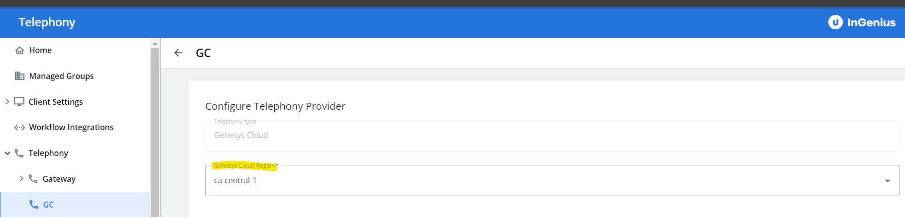

  4. Select your deployment region from the 'Genesys Cloud Region' dropdown box.
  5. Select Publish Changes to save the information on the page once all fields have been filled.

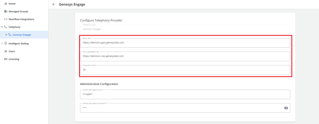

  1. In the Admin App, select the Telephony tab, and then select the telephony profile created for Genesys Engage.
  2. Under 'Configure Telephony Provider', fill in the Base URL and Recording Base URL fields for your Genesys server.
    Note: To find your base and recording base URLs, you will need to navigate to your Genesys install directory to find the 'application.yaml' file for each, your Genesys HTCC and RWS applications. Viewing in a text editor, find the URL listed under 'externalApiUrlV2'.
  3. Under 'Administrative Configuration', set the Admin App Agent Name and Admin App Agent Password fields to a Genesys system administrator's credentials.
  4. Set the Wrap Time to the same duration it is set to in your Genesys configuration, or to 0 seconds if it is not enabled in Genesys.
  5. Scroll down to the bottom of the page and select Publish Changes.

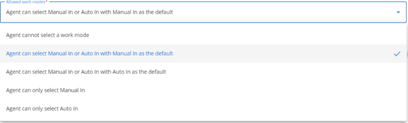

Allowed Work Modes
An InGenius administrator can set which work mode selections are available to agents. One of five options are available:
