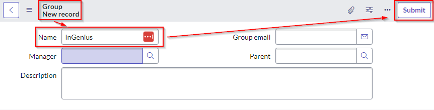

Create New User Group
  1. Login to your ServiceNow Instance.

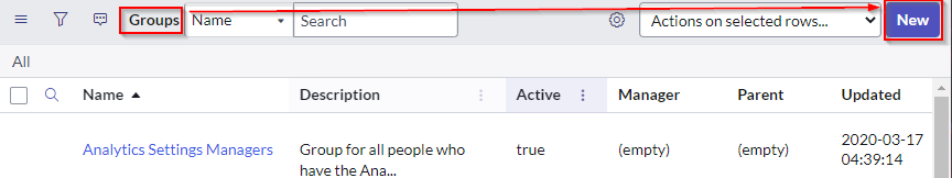

  2. Navigate to All | User Administration | Groups
  3. Click the New button on the top-right corner.
  4. Add a user group with the Name Field "InGenius", no other configuration is required.
  5. Click Submit to save the new user group.

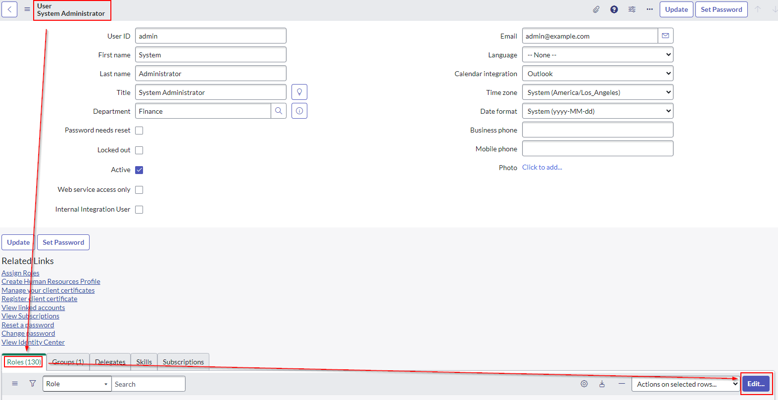

Add Roles to ServiceNow Admin
  2. Navigate to All | User Administration | Users

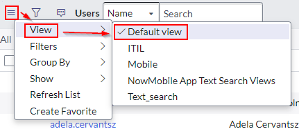

  3. Click the folding menu in the top-left corner, and select ViewDefault View.
  4. Search for a user with the User ID 'admin', and select the user.
  5. Select the Roles tab from the bottom of the page, then click the Edit button.

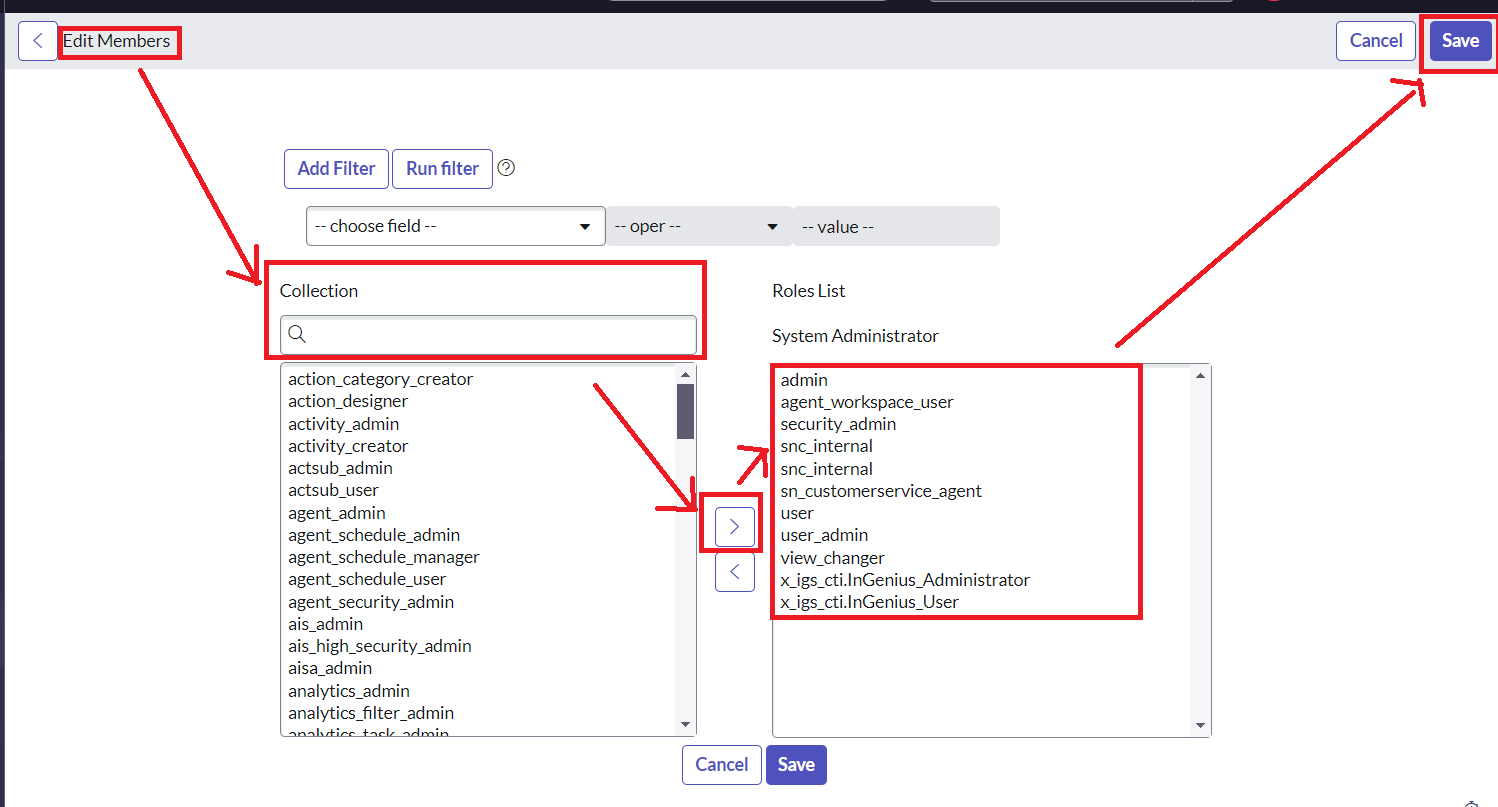

  6. Search for the following roles and add them to the Roles List on the right:
    • Required:
      • x_igs_cti.InGenius_user - Provides access to the InGenius Client app.
      • x_igs_cti.InGenius_Administrator - Provides access to the InGenius Admin app.
      • user and user_admin
      • The admin, security_admin, and snc_internal roles should already be populated in the list.
    • Optional:
      • view_changer - Provides access to the InGenius View for tables.
      • agent_workspace_user - Provides access to the HR Agent Workspace app.
      • sn_customerservice_agent - Provides access to the Customer Service entities.
  7. Click Save.

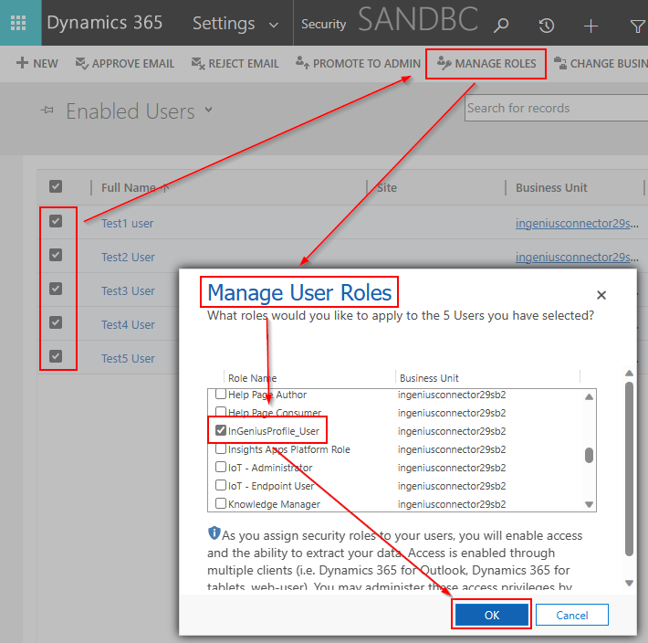

  1. Login to your Microsoft D365 instance, and then select the Settings cog wheel from the top menu, and then select Advanced Settings.
  2. Navigate to SystemSecurity | Users.
  3. From the list, select the user account(s) that you would like to assign the security role to, then select the Manage Security Roles button from the top menu.
    Select the 'Omnichannel Users' drop down and select Enabled Users.
  4. The user role imported from the solution file will be called 'InGeniusProfile_User', select this role and then click the OK button to apply the changes.

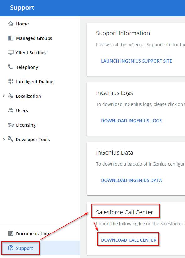

Downloading the Contact CenterCall Center
The Admin App will generate a unique key for your organization and include it in the contact center XML definition file. The downloaded call centercontact center file is ready to be imported into Salesforce without any modifications.
  1. In the Admin App, navigate to Support.
  2. Select Download Call CenterContact Center.
  3. Save the call centercontact center XML file to a location on your computer.

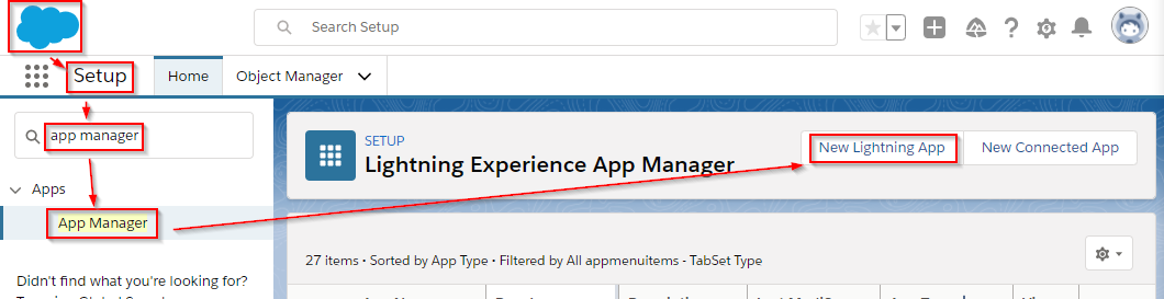

  1. Login to your SCV Salesforce Org and navigate to Setup | App Manager.
  2. Select ​New Lightning App , enter your contact center name under App Details and click Next.

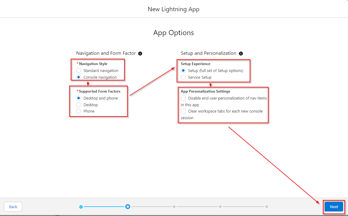

  3. In the App Options page:
    • Select ​Console navigation under Navigation Style
    • Select Desktop and phone under Supported Form Factors
    • Select Setup (full set of Setup options) for Setup Experience
    • Unselect the option for 'Disable end user personalization of nav items in this app'
    • Unselect the option for 'Clear workspace tabs for each new console session'
    • Click Next.

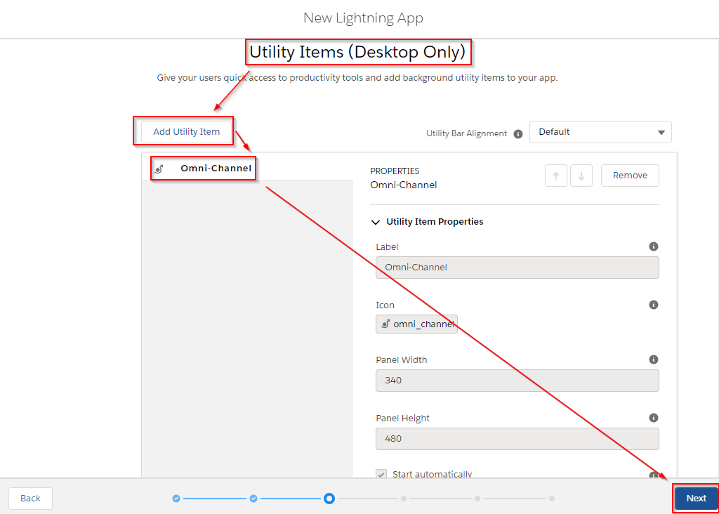

  4. Select ​Add Utility Item.
  5. Select ​Omni-Channel to add Omni-Channel to the utility item and click Next.

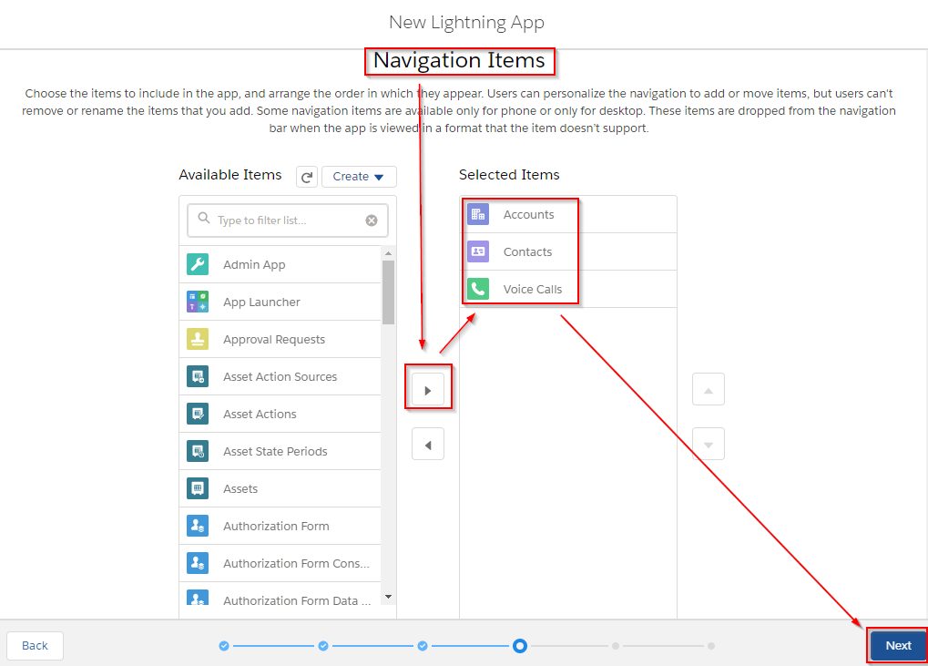

  6. Use the search bar to find the ​"Voice Calls", "Contacts", and "Accounts" navigation items. Select each one and click Add, then click Next to continue.
  7. Leave the Navigation Rules values as their defaults and click Next.
