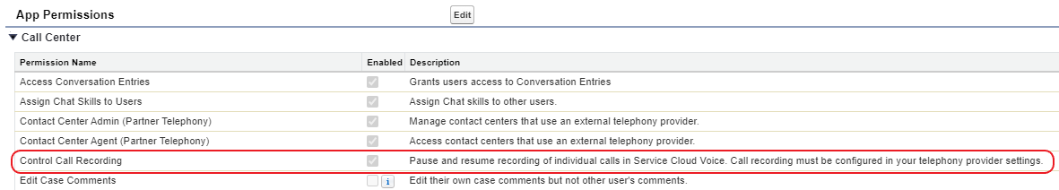

Select App Permissions
Under 'Call Center' permissions, enable 'Control Call Recording'.
The 'Toggle Recording' button should now appear for your agents in the SCV UI, and can be toggled on or off to enable transcription for the call.

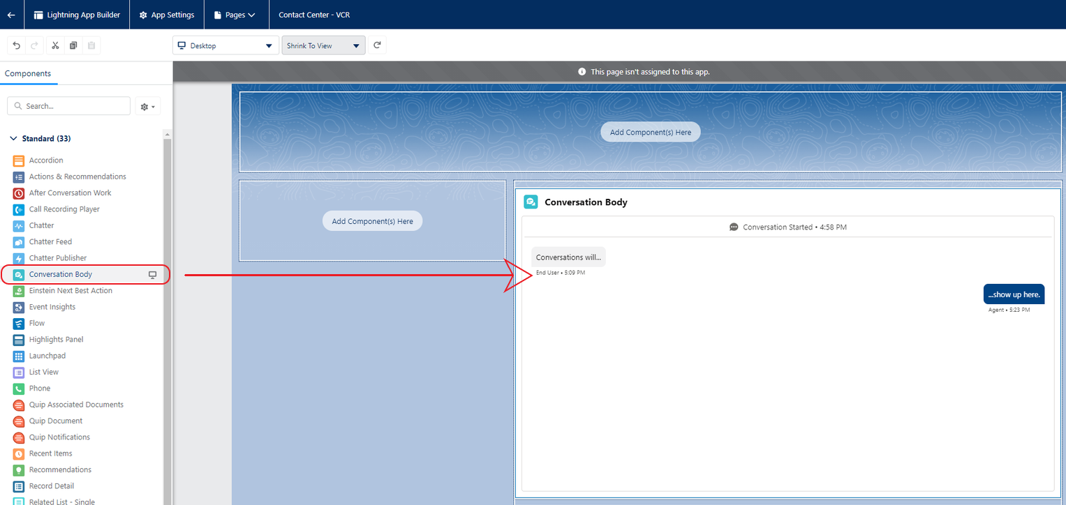

In the Lightning App Builder, select Pages | New Page
Select Record Page on the 'Create a new Lightning page' panel and then click Next.
Add an appropriate label name, select 'Voice Call' from the 'Object' dropdown, and then click Next.
Select a desired layout for the page and click Finish.
Drag the 'Conversation Body' component onto the page layout.

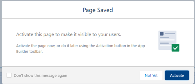

Select Activation from the top menu bar.
Note: If the Activation button from the top menu bar is greyed out, click Save. A pop up will appear asking you to activate the page, select Activate.
