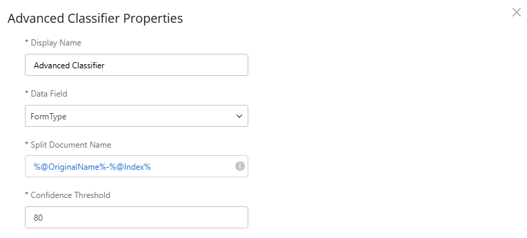

  1. To access stencil properties, double-click an Advanced Classifier stencil. Or, right-click an Advanced Classifier stencil and select Properties.
  2. In the Display Name box, enter a name that will be displayed for the workflow step.
  3. From the Data Field drop-down list, select which data field will be used for the form type.
  4. In the Split Document Name box, specify the filename you want to use for the documents. This field supports data field substitution. The following substitution variables are specific to the classifier stencil:
    @Index The indexer from the current classification action. For example, if the classifier breaks the original document into 5 sections, then each section would be numbered 1, 2, 3, 4, 5.
    @OriginalName The original name of the document when submitted.
    @PageSection The page section that this document represents from the original document. For example: 1, 1-3, 5-10. This can be either a singe page number or a page range.
  5. Adjust the Confidence Threshold as needed. If the document is returned with a confidence equal to or above this threshold, it is classified according to the suggested form type. If it is returned with a confidence below this threshold, it is marked as unknown. The confidence percentage can be viewed on the Data Fields tab in Document Properties.
  6. Click Save.
