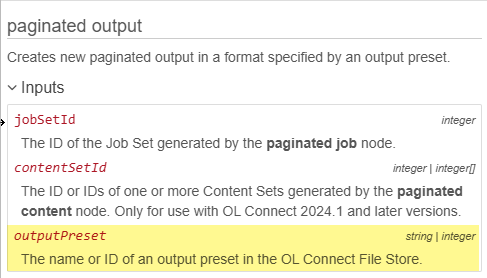

Several OL Connect Automate nodes, including the paginated output and all in one nodes, support dynamic configuration through message properties. While the output preset can be statically defined in the node configuration, it can also be supplied dynamically via msg.outputPreset as shown in the embedded Help for this node:
A portion of the embedded help for the paginated output node, showing that output Preset can be an input.

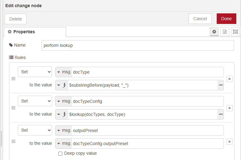

To enable this, add a separate change node after the lookup step, or add an rule and configure it as follows:
  • Set: msg.outputPreset
  • To the value: msg.docTypeConfig.outputPreset
The properties of a change mode, as seen earlier in this guide, with an additional rule as described in the preceding text.

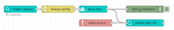

The sample flow with the nodes as described in the preceding text.
