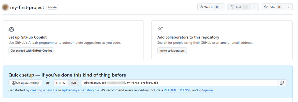

Copy the SSH URL from GitHub
  1. In GitHub, open your newly created repository.
  2. In the Quick setup area (visible for new/empty repositories), select the SSH option.
  3. Copy the SSH URL, which looks similar to:
    git@github.com:<your-github-account>/my-first-project.git
GitHub window for setting up communication with the new repository.

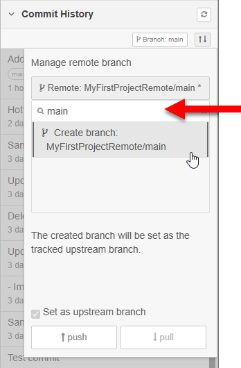

Push files to the remote repository
  1. Open the History tab of the right sidebar.
  2. Open the Commit History panel.
  3. Click the Manage Remote Repository icon
Commit History panel, with the manage history icon identified. The icon is a small square with two arrows; one pointing up and one pointing down.
  1. Click the Remote button.
  2. Enter the name of the branch you want to push to.
    • For GitHub repositories, the default branch is typically main.
    • If it does not yet exist in the remote repository, entering main will create it.
  3. Select the main branch from the list.
  4. Click push to upload your project files to GitHub.
Commit History panel, with the manage remote branch selected. The main branch (only one showing) is highlighted.

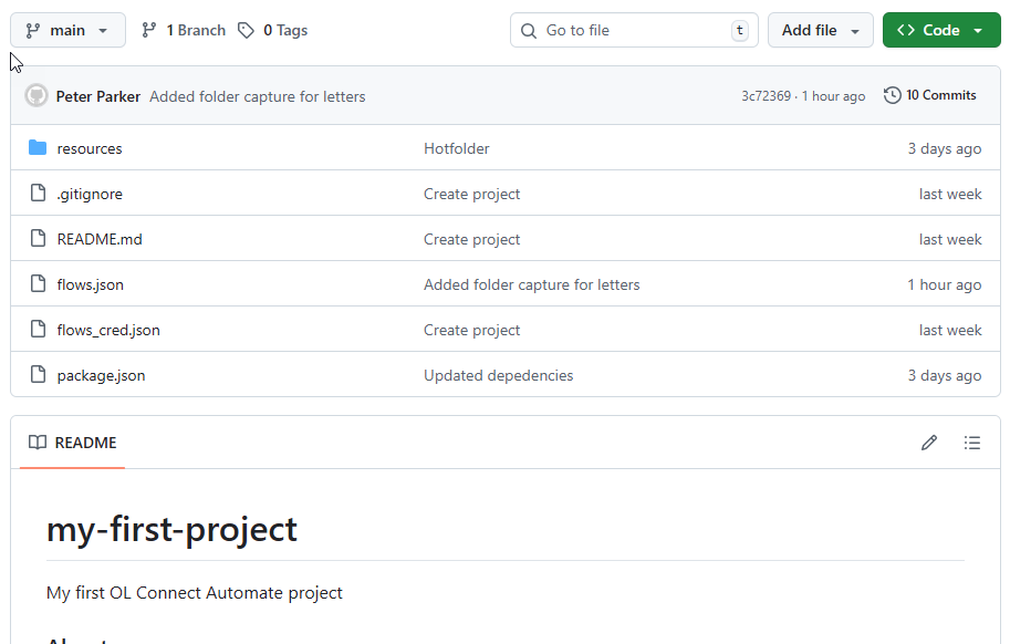

  1. Once the push completes, you can confirm the files are in the repository:
    1. Return to your GitHub repository in your browser.
    2. Refresh the page to see your project files appear in the repository.
Browser window for the GitHub repository, showing a list of file from an OL Connect Automate project.
