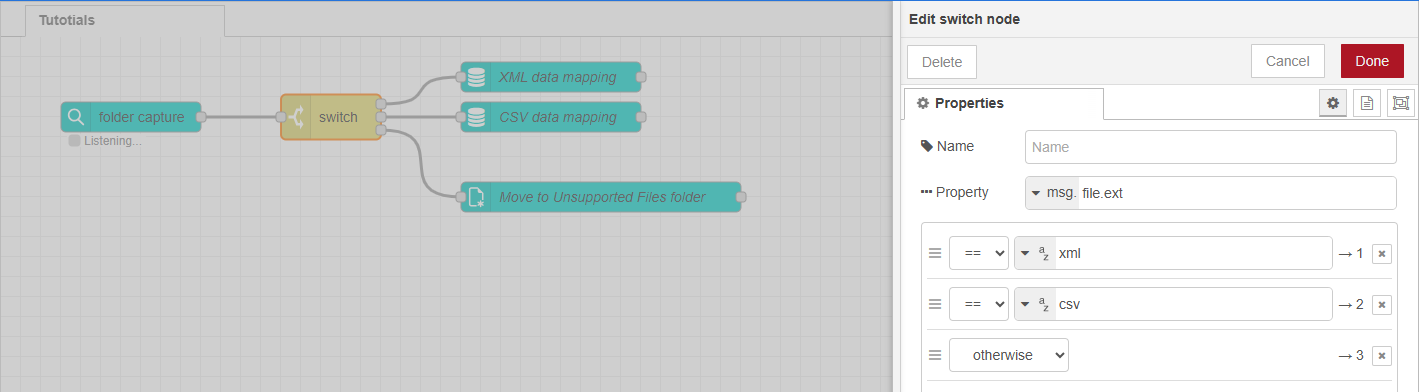

The switch node allows you to define multiple conditional rules, such as text-based comparisons, against a specified message property (e.g., msg.file.ext). Each rule evaluates the inputted property value and routes the message to the corresponding output if the condition is met.
Routing by File Extension
This flow uses a switch node to evaluate the msg.file.ext property. That property is selected in the Properties panel for the node.
Flow showing the folder capture node, connected to the switch node, with three connected nodes for different file extension results.
  • If the extension is xml, the flow continues to an XML data mapping configuration.
  • If the extension is csv, the flow branches to a CSV data mapping configuration.
  • If the extension doesn't match any defined rule, the message is routed through the otherwise output. This fallback can be used, for example, to move the file to an unsupported folder or log it for manual review.
