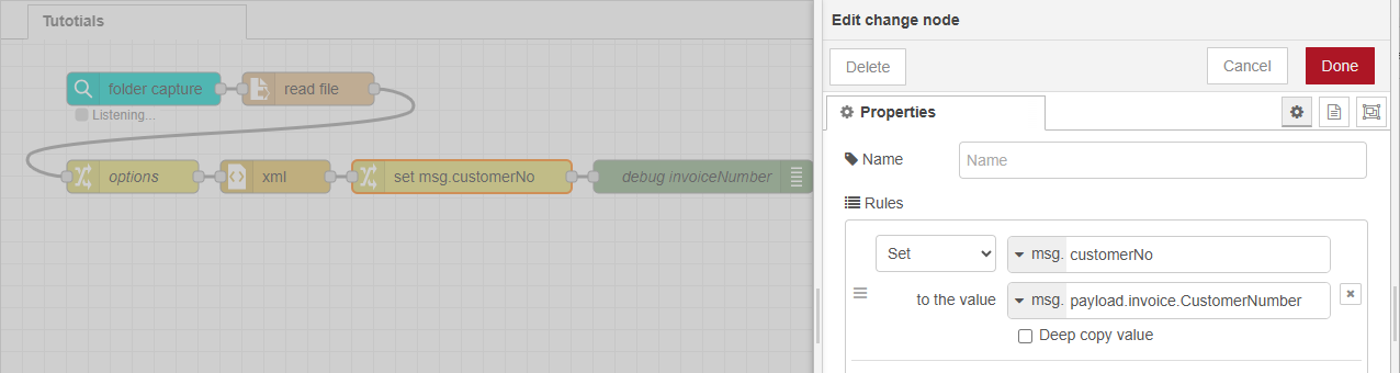

  4. Add a change node after the xml node.
  5. In the change node properties panel, set a property (e.g., msg.customerNo)
  6. Use the Set to option with the copied path as the value.
Flow using folder capture, read file, options, xml, change, and debug nodes, and showing the selected properties for the change node.

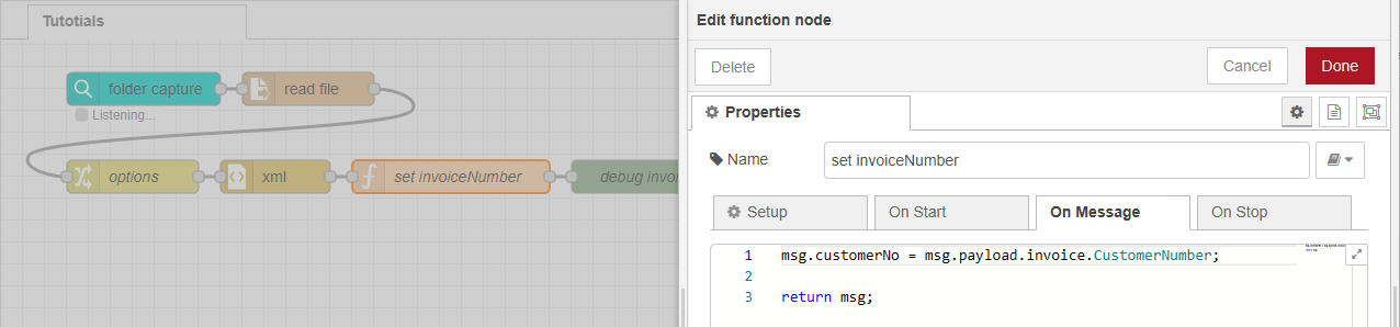

Use the function node
If you prefer scripting or need more control (e.g., conditional logic or transformations), use the function node. This node gives you direct access to the msg object and allows you to manipulate properties using plain JavaScript code. Enter the code in the On Message tab of the function node properties.
msg.customerNo = msg.payload.invoice.CustomerNumber;
return msg;
Flow using folder capture, read file, options, xml, function, and debug nodes, and showing the selected properties for the function node.
