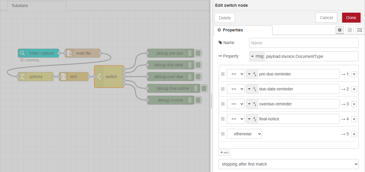

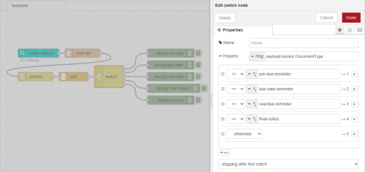

Routing by Document Type
In this example, the flow checks the value of msg.payload.invoice.DocumentType using a switch node.
  • If the value is "pre-due-reminder", the flow continues to render a pre-due reminder template.
  • If the value doesn't match any of the defined rules (e.g., rules 1–4), the message is routed through the otherwise output. This fallback can be used to render the default invoice template.
This technique enables type-specific processing logic based on the content of the incoming data, allowing the flow to dynamically adapt to different document types.
A sample flow showing the steps involved, and five debug nodes after the switch node.
