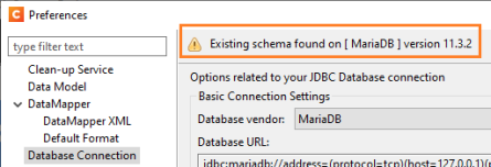

    • Test Connection: Use to test if current connection settings will connect to the specified database.
      If successful, this will display the version of the database at the top of the Preferences page.
    • Restore Defaults: Will restore the settings to OL Connect HyperSQL standard defaults.
    • Apply: When a database connection is confirmed as correct this button becomes active, and is used to actually apply the database swap.
