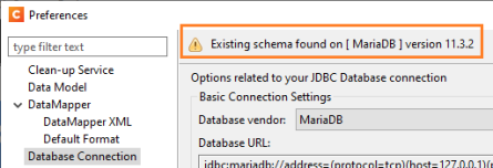

Database Connection preferences
Dialog used to change the OL Connect back-end Database.
This dialog supports the swapping of the back-end database between various vendor databases. Note, however, that the alternate vendor database(s) must already be installed and available in order to swap to them.
This is not a migration tool. It is a simple connection tool, that enables shifting to a different back-end database. Any existing data will not be transferred/ migrated between the databases, and any existing File Stores will be cleansed by the Clean-up Service after the swap.
When shifting to a different back-end database, the changes won't be applied until OL Connect is restarted. Including the Connect services. A full machine restart is recommended, as this provides the cleanest restart of all the services.
  • Basic Connection Settings selections:
    • Database vendor: Select the database type from the drop down list.
      Note: Moving from one vendor database to another will reset all screen selections to defaults, regardless of what may have been previously selected.
    • Database URL: This is a read-only summation of the current database connection settings.
      Tip: If the Test Connection button shows that the database cannot be successfully connected to using the selected settings, then the contents of this field could be used to try to connect to the database outside of OL Connect. This should help in determining and refining the acceptable connection options.
    • Hostname: Enter the IP Address or alias of the server where database resides.
    • Use default port checkbox: Select to force the use of the default port for the selected database type. This will enable the Database Instance Name selection, when used with a Microsoft SQL Server.
    • Database Instance Name: Enter an existing Microsoft SQL Server's instance name.
      This option only applies to existing Microsoft SQL Server instances, and not for MariaDB or MySQL.
      Note that the Microsoft SQL Server instance name must meet Microsoft's requirements.
    • Port: Enter Port number. The initial selections are those which the vendors use by default.
    • Schema: The individual database schema, within the vendor database. The default is olconnect.
      Note: If a previously non-existent schema were chosen here, then a new schema of that name will be created within the database when the back-end database swap is applied. The tables within that schema, though, will not be created until Connect is restarted.
    • Use Windows Authentication: Select to use Windows authenticate for database login. This option is only available for Microsoft SQL Server back-end databases. Selecting this option disables the Username/Password fields.
    • Username: Enter the database login username. This was initially set during the installation, and the default is olconnect.
      Tip: It is considered best practice for this user to have root privileges.
    • Password: Enter the password associated with selected username.
  • Advanced Connection Settings selections:
    • Maximum concurrent threads: This option sets the maximum database threads.
      The maximum setting is determined by the specific capabilities of the machine Connect is installed upon (CPU speed and the amount of cores being the major determinants).
      Tip: Leaving this value set to the default maximum should be the best option in most circumstances.
      We recommended this entry be left at the default value.
    • Custom database parameters table: These are extra parameters which are appended to the database connection URL. The default values are those which have been determined to be useful in connecting to specific vendor databases.
      For example, in order to use Integrated Authentication with Windows, specify the property integratedAuthentication with the value true, which adds integratedAuthentication=true to the URL.
      • Property: These are free field text fields.
        Note: These fields and their associated values get appended to the JDBC connection and therefore must follow all rules regarding acceptable URL addresses for such.
      • Value: The value applied to the associated Property.
      • Add: Used to add extra Property values to the table.
      • Delete: Used to remove existing Property values from the table.
    • Test Connection: Use to test if current connection settings will connect to the specified database.
      If successful, this will display the version of the database at the top of the Preferences page.
    • Restore Defaults: Will restore the settings to OL Connect HyperSQL standard defaults.
    • Apply: When a database connection is confirmed as correct this button becomes active, and is used to actually apply the database swap.
The Database Connection preferences also provides you with buttons to :
  • Test Connection: This will run a test on the current Database Connection settings.
  • Restore Defaults. This option restores the preferences to Defaults. This applies to the current Preferences page only, not any other Preferences.
  • Apply: This option applies the settings made within the current Preferences page, but does not close the Preferences dialog.
